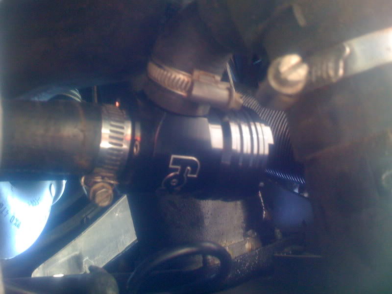

i want to make sure i did this right, the diy's dont seem right for some reason
i installed my DV today and want to make sure i did it right i read the instructions from forge and from the picture they showed the way mine is looks nothing like the picture
and i need help fast my car is up on jacks right now

Close up from above looking at the bov end
Looking down from top
Stock DV i took off

well theres only 3 things you need to connect, as long as the small hose goes to the nipple on the top, and the 2 big hoses go to the two big connectors on the side, your good. you can even mix up the two large hoses and it will still work just fine. from the pictures it looks like all 3 are connected, so your good.

well what i did was when i took off the stock dv i pushed in on the inlet and pushed in on my new one and connected the corresponding end to the hose i disconnected. ok then thanks
