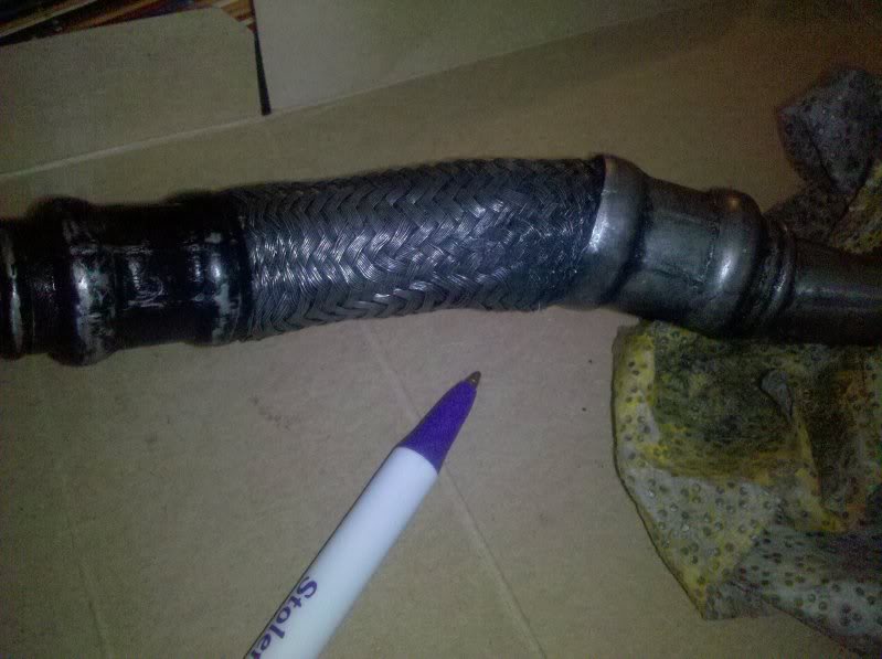

Your link doesn't work for the oil restrictor in your other post, but it in fact needs to be the one with the smaller hole made for the GT BB turbos. I use that same one. Problem is that your drain was kinked acting like another restrictor.
If you use a oil adapter that is too large you can blow out the oil seals on the turbo. The restrictor decrease the oil pressure inside the CHRA since our cars have very high oil pressure which the GT BB CHRA can not handle.

This is why I had it rebuilt. Because it looked like this and the braid was coming apart.
