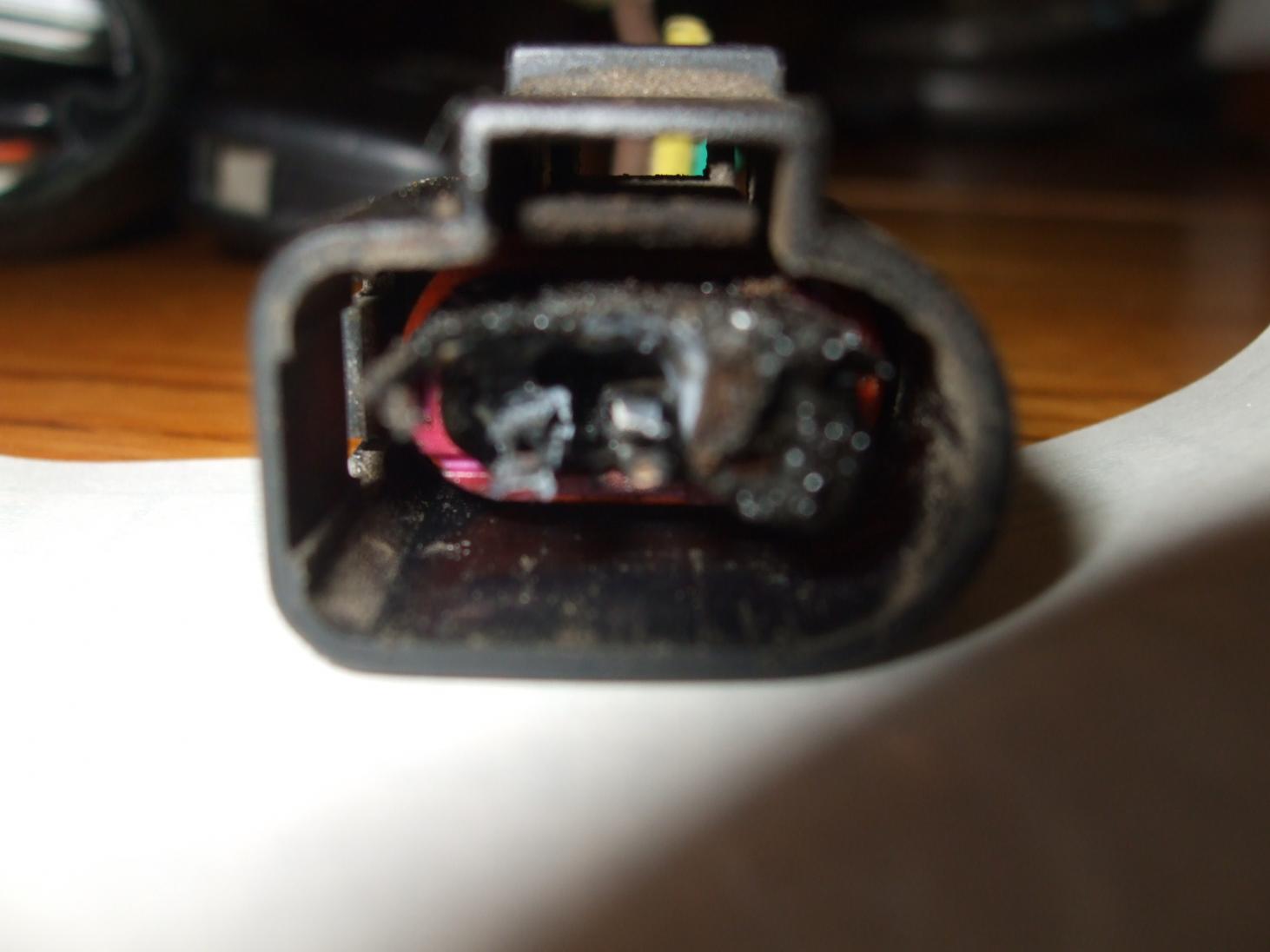

First of all, thanks for this post. I had already checked fuses 25 & 26 with nothing abnormal but after reading this I looked at fuse #5 and it was blown. I replaced it with another 10 amp and like above, it blew within 2 seconds, so I went ahead and tried a 15 amp fuse (which I realize most people wouldn't recoment or try) but believe it or not the radio turned on and so did the climate control/ac fan. Heres the weird part, as this was happening I could smell electrical smoke and saw it coming from the hood near the drivers headlight. I turned off the key right away opened the hood and it looks like the smoke was coming from the wiring I soldered into place when my oil temperature sensor ripped out. I removed the wire from its clip on the water pump and pulled it back then started the car and the climate control, fan, and radio all work great and no smoke.. I'm going to pull my car into the garage now and re-insulate my oil temp wiring and hopefully thats the end of it. My symptoms of the origional problem were no heat or a/c, no climate control system power, no radio initially but soon noticed that it still worked but wouldn't turn off when I removed the key. Good luck

Expanding upon my previous post, I just got done removing the connection for my oil temperature sensor on the bottom of the oil pan. It was the cause of my radio/climate control problem and was melted internally. It looks like the #5 fuse, climate control, blower fan, and radio are all related. Apparently the sensor itself shorted out and was the cause of my smoke and blown fuses. Good luck and hope this helps someone out..
