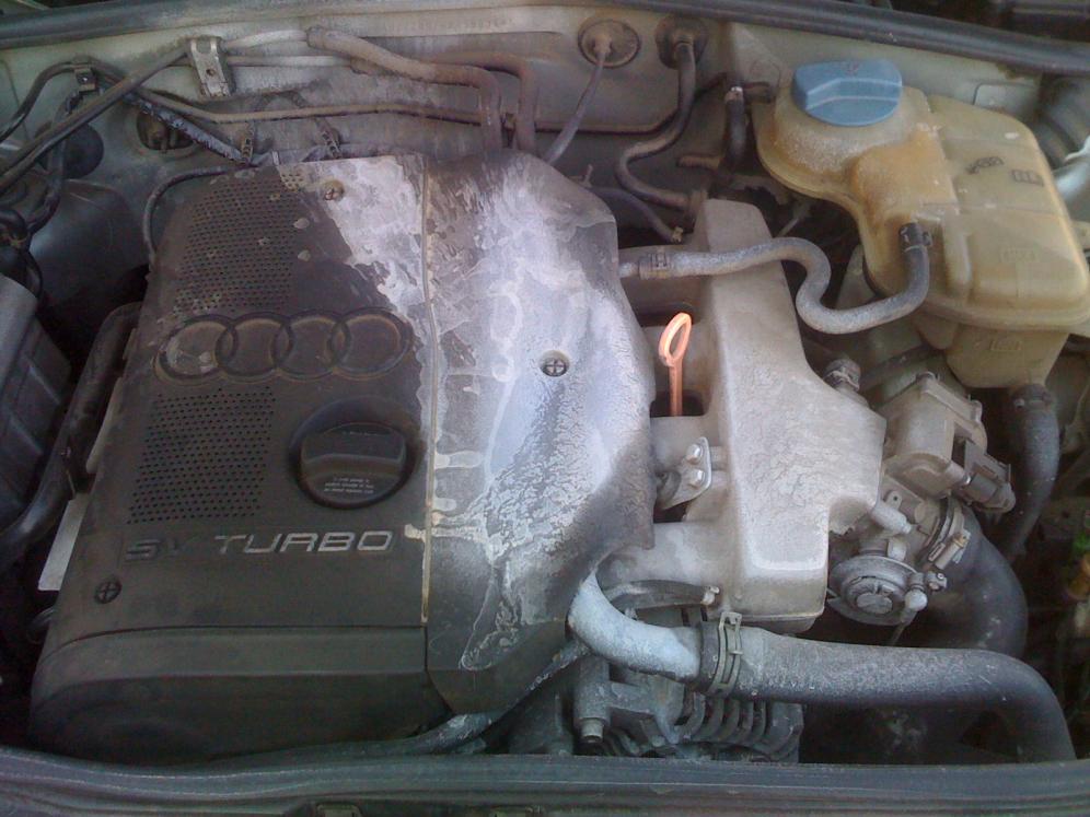

I am not sure what filter is in it. I have only had the car for about 3 weeks and the previous owner had the oil changed right before I bought it. He told me he used Mobil 1 5-30, or 0-40 depending on weather. The coolant temp is dead center and moves only if at idle for a while (the oil climbs then as well). The coolant is full last time I looked about 3 days ago. No noticable leaks or anything. The valve cover has a little leak, but that is it.
I thought it was high too..which is why I am concerned.
The previous owner had a lot of cooling work done before I bought it. The car was overheating. He had the water pump, thermostat, 2 hoses, oil change and had an AC charge.
Edit: Added photo he sent me of the car when it was overheating.

Well, I took her into the shop on Saturday. It looks like the oil cooler is clogged, which would explain why the oil won't cool down. You can see the coolant seeping from it. It also looks like the someone put the "green" coolant in the car. Ick! So, I am having the oil cooler replaced and the coolant system flushed and an oil change. I am hoping this will fix matters
