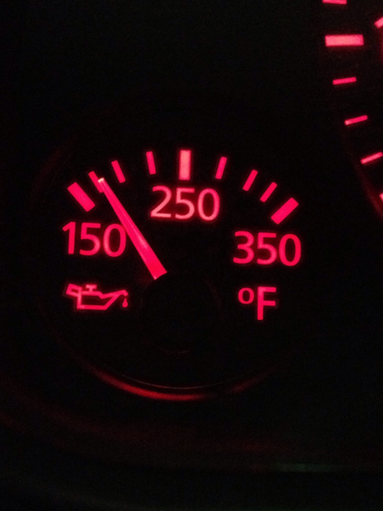

Pbcrazy 10-11-2012 03:00 PM
1 Attachment(s)
Here is a picture of my gauge after 20 minutes of driving, engine was warmed up and coolant gauge was directly in the middle
Attachment 28105

redline380 10-11-2012 08:17 PM
i wouldnt say sludge. id say thermostat staying open. just myopinion though. either that or the oil temp sensor is bad
