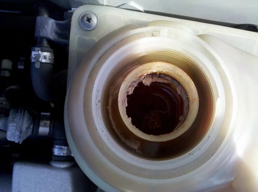

It's definitely possible. When you mix G12 (pink) with regular parts store coolant (green) there's a chemical reaction and it turns into a brown soupy/peanut butter mess. These were taken of my car the day after I brought it home:
The best way to get rid of it is to replace the whole cooling system, but obviously that's cost prohibitive. I replaced the coolant tank, a couple of the more gunked up radiator hoses (and one that cracked later on), the t-stat, t-stat housing, and then flushed the whole system. I've had to flush it two more times since and replaced the coolant tank again, as the gunk tends to hide in there.

Yeah mine was an extreme case but you get the idea. I have a feeling a clogged heater core is causing your problems though.
