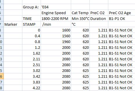

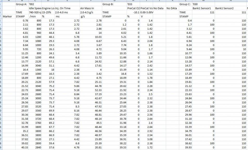

I have some kind of issue with a 2001 Audi A4 1.8t. I recently replaced all the coils because 1 was bad. This made the car drivable, but I am still getting the following codes. I tried driving very fast for a while in case the sensors were carboned up, but it did not help. I have attached some screen shots of some logs. Does it seem like the Pre-cat o2 sensor is bad?

Yes, it looks like the pre-cat sensor is bad. B1 S1 is pre-cat. B1 S2 is the post-cat sensor. They're usually under $150 online. Just make sure you check your engine code and get the correct one.
