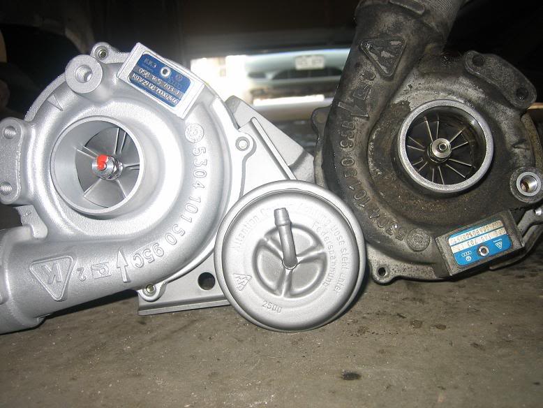

Just received my new replacement turbo today. Unfortunately, I think the order was screwed up. I ordered a KO3S for a quick replacement due to the fact that I couldn't find a new KO4 asap. I think I received a plain old KO3. Doesn't the KO3S have the same compressor wheel (8 blade) same as the KO4? The turbo I received has twelve blades. The part number is K303 988 0029 (HD71005841). Can anyone confirm this?
[IMG]local://upfiles/53779/14F4907D15304F10AEFE94059DA0AAEF.jpg[/IMG]

Shot of my K03 that came off my 2000.

k03 vs k04 (i think)
http://www.audiworld.com/news/99/turbo/lo4lko4r1.jpg

Bigger turbo FTW! HAHA
But seriously those are not the same.

This is my stock k03 vs. the gpop k04 (yes it's a k03 housing with a k04 compressor wheel in it)

You got yourself a ko3

the only difference between a k03s and k04 is that the k04 wheel is a few mm bigger I believe. the blades look the same.
