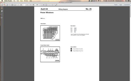

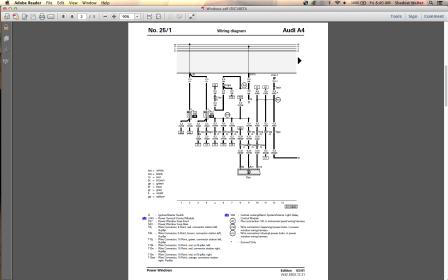

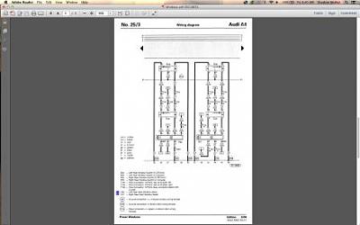

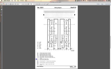

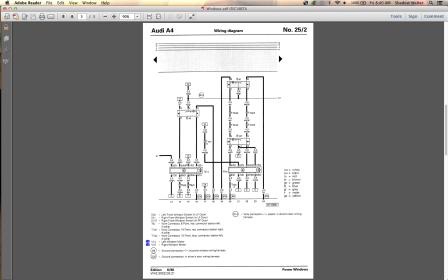

Here's the wiring diagram for the windows, sunroof and the lockout switch on the doors for the B5s. Hope this helps a little.
Attached Thumbnails Power Windows-1.jpg   Power Windows-2.jpg   Power Windows-3.jpg   Power Windows-4.jpg   Power Windows-5.jpg
