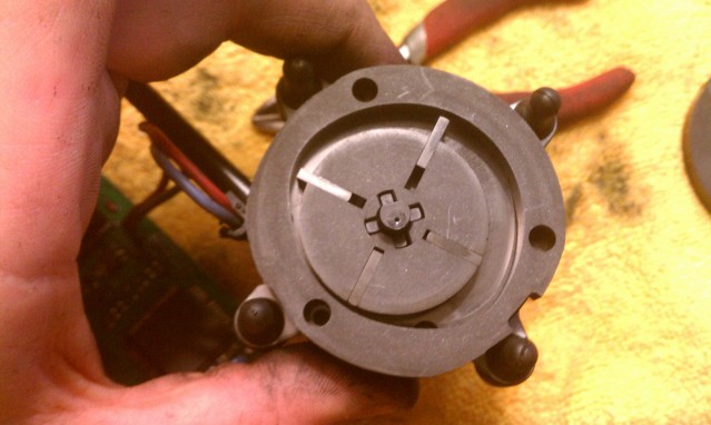

Thank you, this did solve the issues though....so actually, when I hooked up the used "new" pump the power locks didn't work. Since it wasn't my car I wasn't sure if they ever worked, and chalked it up to the switch being bad. When I asked about it I found out that with the old part they did work. So after a bit of trouble shooting, I figured out the air pump in the module wasn't working properly.
I decided to give it a shot and take the good parts from each module that I had and make one good module. Took a few pics just because I thought it was interesting, and figured some others might too.
Two modules torn apart. The black thing connected to the circut board is the pump, all I had to do was unplug, and plug in the blue and red wires:
Here's the good pump's guts. Looks like I nice little pie.
Here is the inside of the bad pump, you can see all the pieces jumbled together, definetly the cuprit.
So now I can officially say that the issue is fixed.
