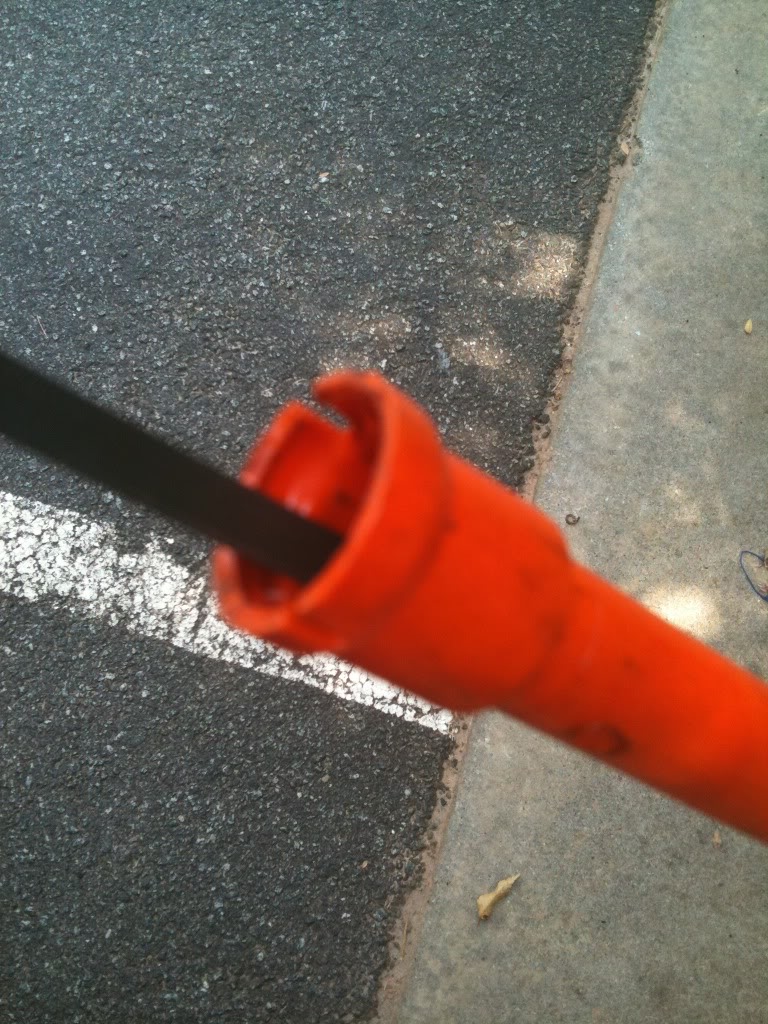

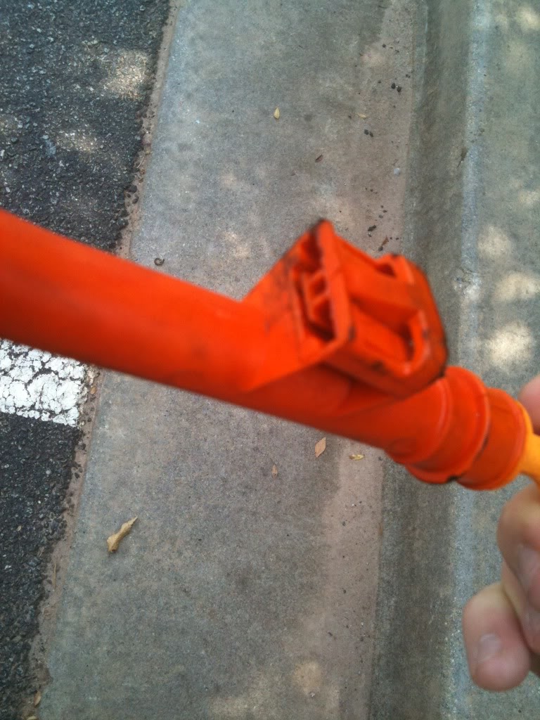

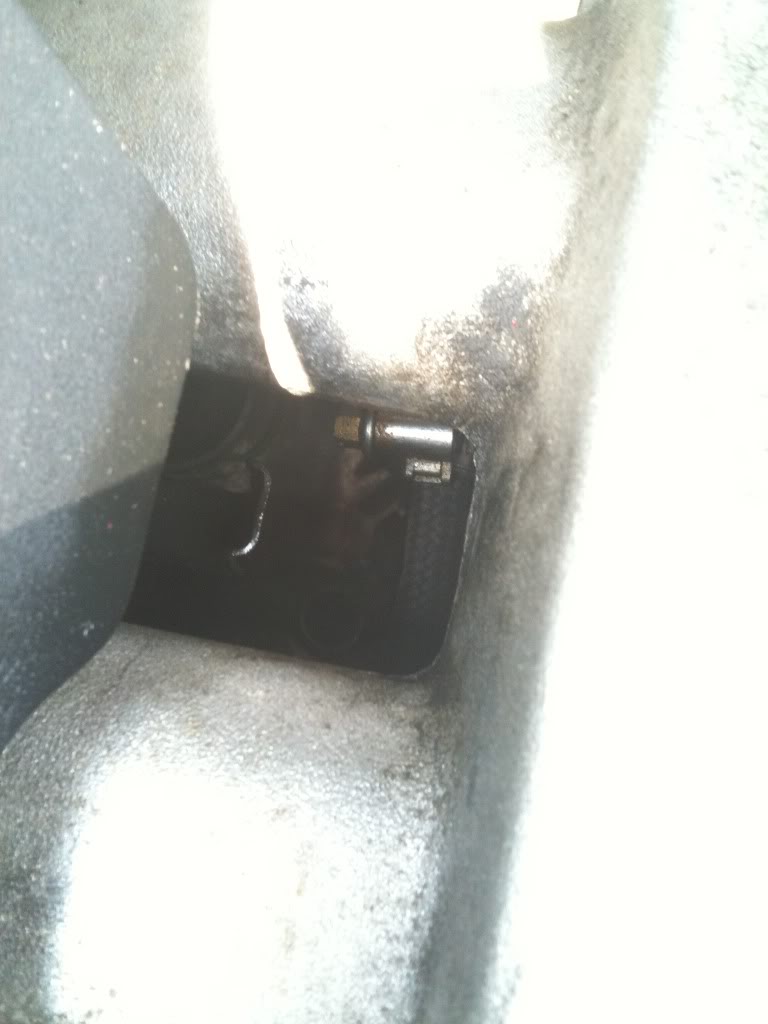

Heres a few pics:

The clip doesn't fit into the sleeve socket. Let me know what you think.

hmmm, thats pretty much exactly what mine looks like man. It was a pain in the ***, but it oughta fit unless there's somethin there i can't see in the pic?

there was a split in those year/s the dipstick tubs look the same but one is shorter and fits different in the slit go here to see which tube you need and dipstick Only reason I know is I have been focused on making a one time fix replacement for this problem

That may be it because when I got my oil changed and a few other things this past weekend, the tech said that he used to have an audi same year as mine and the dipstick should be farther down in the engine. When I get out of class today im gonna take the cover off and post a picture of where it is when in the engine so you guys can see if it's far enough down.
On another note, I guess it's not hurting anything because it is still sealed good just when I push it in there.. but it's still frustrating none the less..

where is the long metal piece that goes into the base???
then the tube right that correct ?? as there are two tubes that have that very same looking one but one is shorter or the other one is longer depending how you look at it as there was a mid year change on that model
go to ecstuning they have the pics and if need be I actually have the tubes ect............ look your model up go to maintence (SP) and the eggine click dipstick at top

I looked on ECS and it looks pretty identical.. Im gonna try to reposition the metal clip after class today and try to jimmy rig it to where I can try to fit the sleeve in it..

inside the plastic the other ring od plastic breaks off both where the metal does through is 5/8 of an inch
