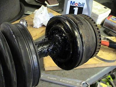

Default What I found so far
Here's a pic of my CV joint I suspect caused my noise. I found the smaller boot clamp had broke at some point but it didn't look like there was any grease coming out of it. I don't see any broken pieces inside yet, but there is some play in the joint in a twisting motion. There wasn't as much grease as I thought there should be, but it wasn't dry either.
http://www.youtube.com/watch?v=cEYpc-kdaRw
Anyone think the inner part of the joint could have "slipped" on the splines of the shaft?
