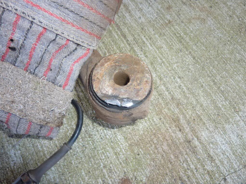

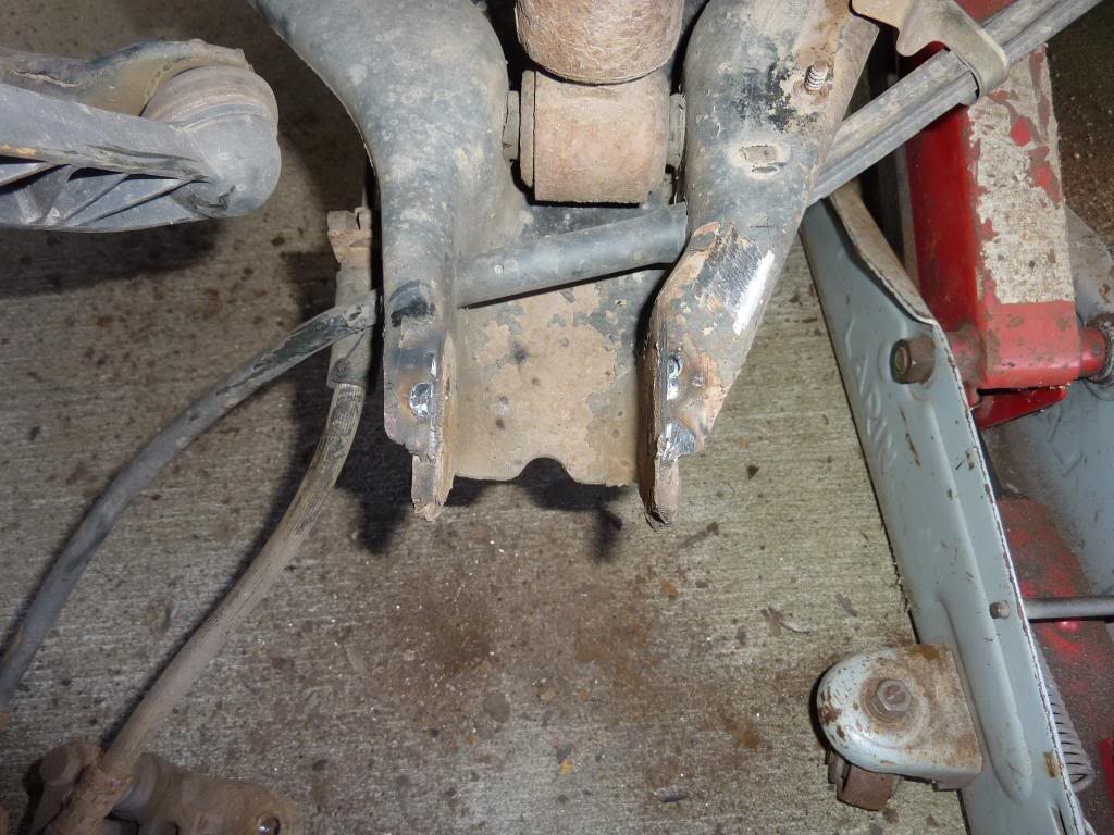

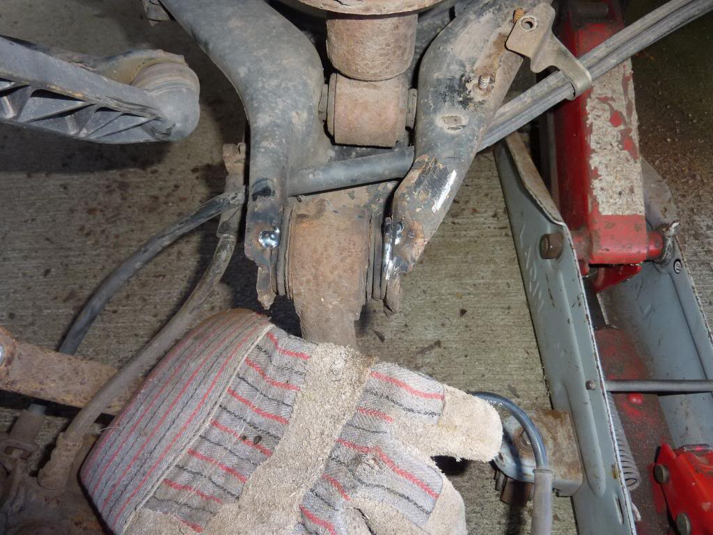

I recently replaced the other sides wheel bearing (RR) and came up with what I think is a better way to get the camber bolt out. I tack welded the metal sleeve halves that the bolt gets stuck in to the control arm and then worked the bolt back and forth and side to side until it came out. Then, I cut the tack welds with a cutoff wheel, cleaned up the weld area and shot some paint back on. Worked pretty well. Jeff
