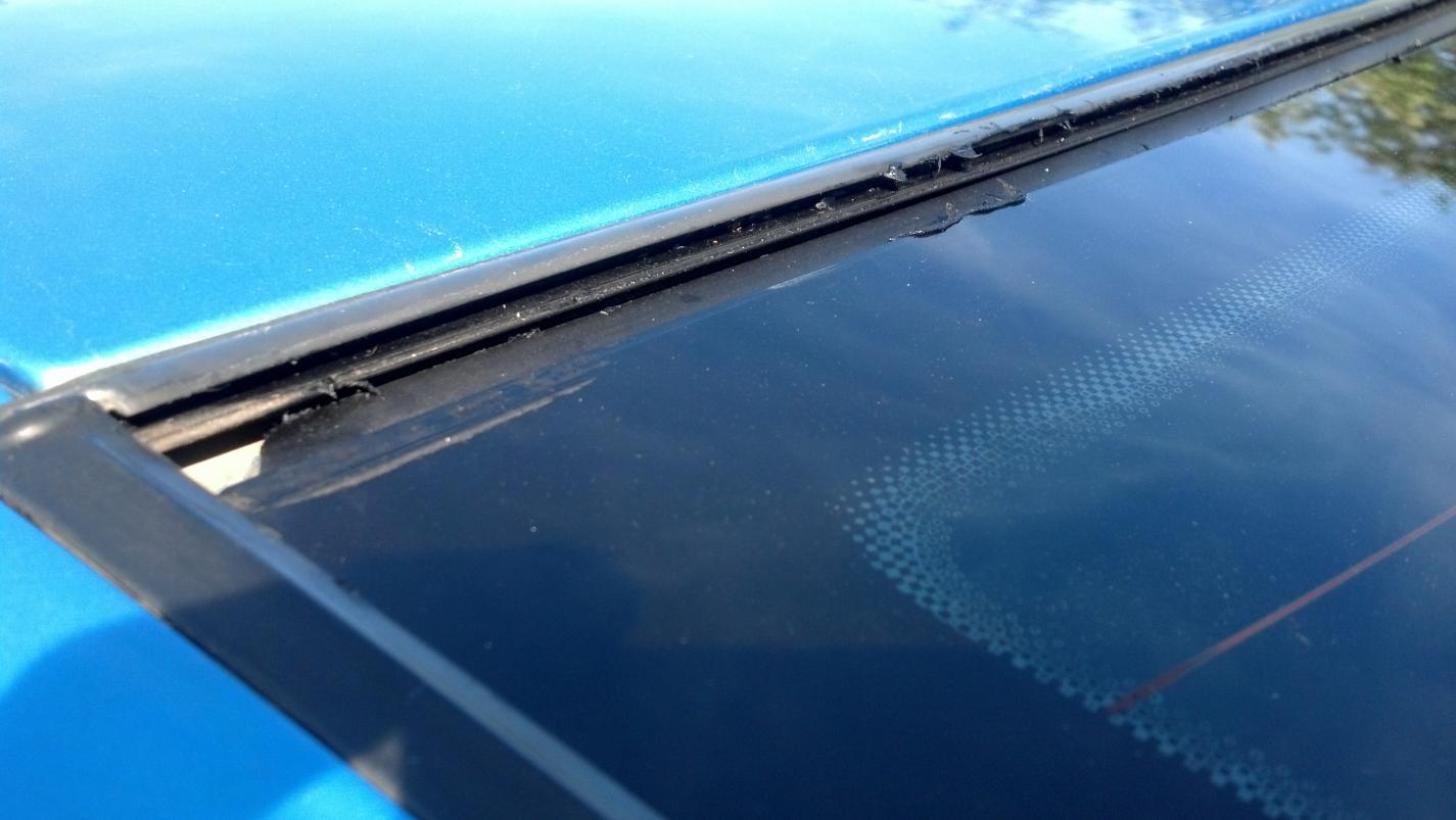

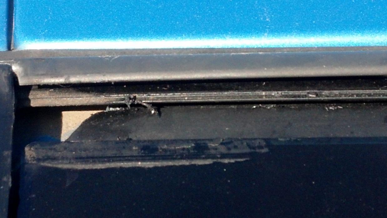

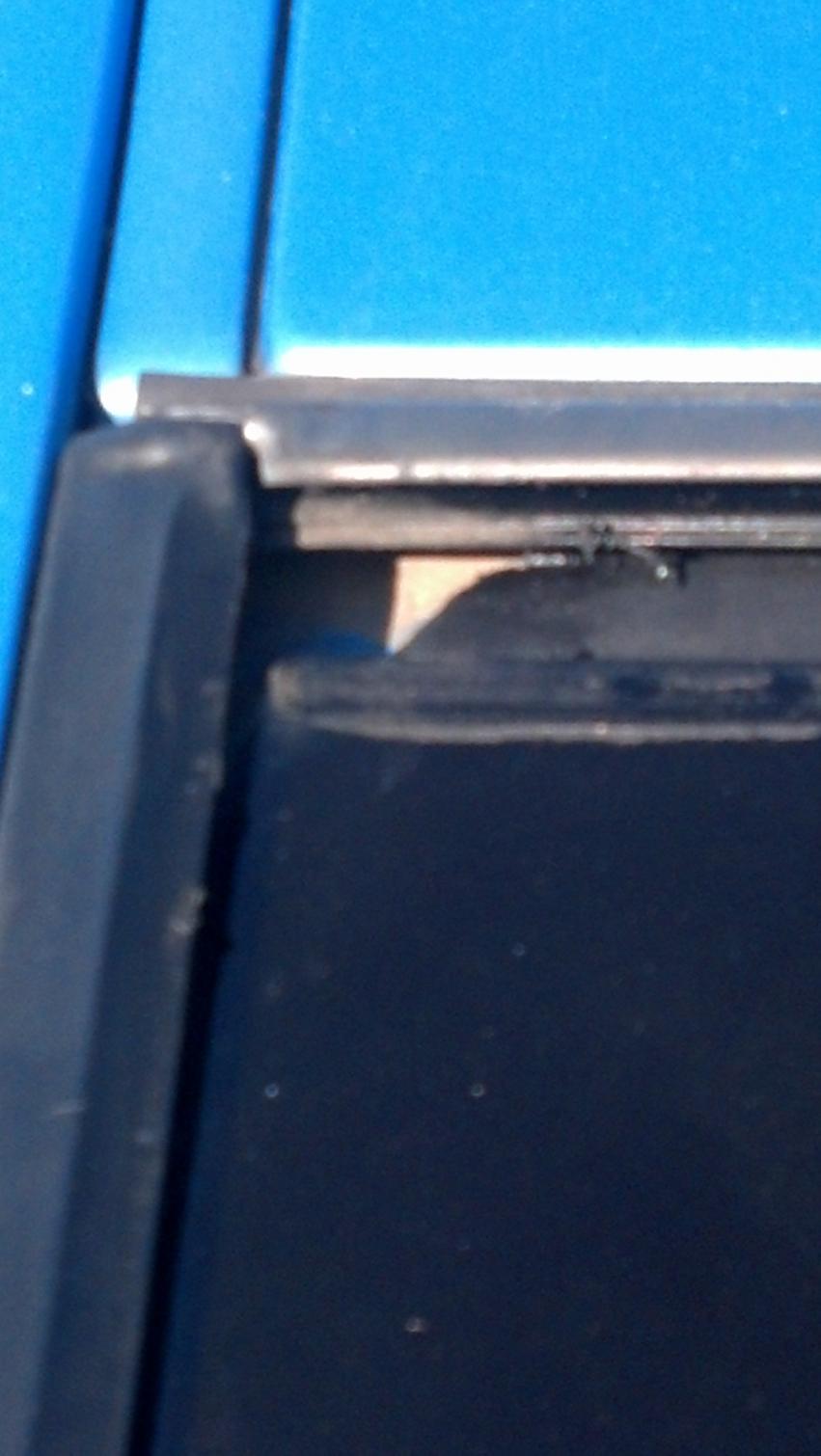

Default Photos of rear window separation
Here are photos showing the rear window separation.
It slid down until it is resting on the trunk.
Attached Thumbnails rear windscreen adhesive failure-img_20130906_173646_609.jpg   rear windscreen adhesive failure-img_20130906_173729_128.jpg   rear windscreen adhesive failure-img_20130906_173739_536.jpg

Never ever seen that. Couldn't have come from the factory that way.

Judging by the way the glass slid and the appearance of the urethane, it was the wrong stuff. The correct glass setting adhesive melts at something like 250*(f) and even then, would probably still keep the glass from sliding down.
You may be OK with the defroster. the connecting wires on either side of the glass are long enough. Otherwise, only need to glue the terminals back to the grid of they came off. The glass guy should have the stuff to do that in his van when he (or she) comes to fix the window.
