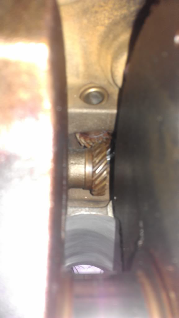

Can anyone tell me if this is oriented right? Is this for the distributor? This is right next to the 4th cylinder in the corner.

You don't have a distributor, that's the intermediate shaft that drives the oil pump.

Oops... Can you tell if that small gear is upside down? How should it seat in there?

it looks liek its in wrong, the gears dont line up
