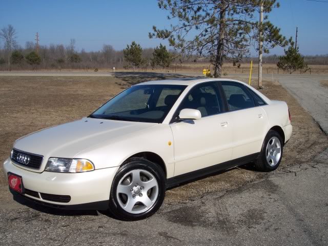

Her car

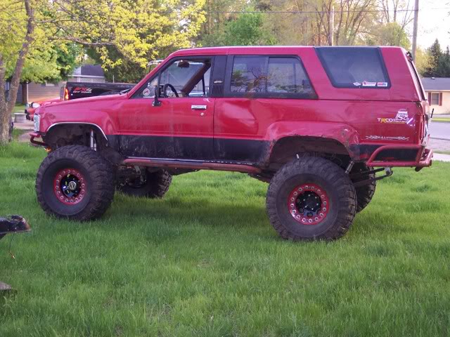

We are most recognized around here by the yota

Nice truck. My old lady works at Mid . Good ole Gladwin. Better than Harrison these days.
