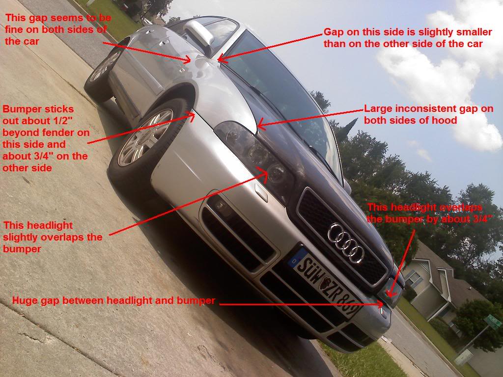

I finally took the pictures, but now I can't upload them because I can't find my card reader. I'm going to inspect and measure anything I can and note anything that looks like it may be out of the ordinary. What's the body piece called that makes up the side of the engine bay (also the part that the fender bolts onto)? I'm thinking that part is probably damaged too.

Inner Fender Well...

Thanks Midniteoyl. I was able to find this pic and just now drew on the lines and measurements I took today. It's old, but nothing has changed since then. This pic was taken after I added the new hood and bumper (obviously). The bumper was also adjusted to its maximum settings to compensate for the bent frame, so the damage is probably worse than it looks.

Another thing I forgot to mention is that the headlights won't mount mount properly, even after installing the new radiator core support. The mounting being off means that the aim is way off, regardless of how much I adjust it.

Good idea chocalotstarfish, but I just replaced them with coilovers. I am thinking that the part of the cowl where the shock is mounted may not be where it's supposed to be though. Is there any way to check this without any expensive equipment?
My goal is to find out what parts are definitely damaged, what parts may be damaged, and what parts are definitely not damaged. I'd like to figure all of this out prior to taking it anywhere.
