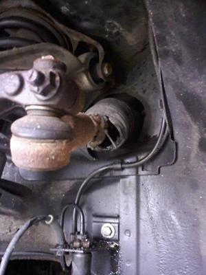

lately i've been having to put in more powersteering fluid the usaual so when i put my winter rims on saw this and jacked up it was dripping bad... i was just wondering what u think the problem is and if its a do it your self or take it to the garage type thing.... anything at all would be a big help....thanks

time for a new steering rack

replace it and if you dont have the money to do it i would tie wrap it than put some rubber sealent to get it sealed well
