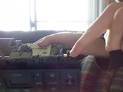

no tearing out required, on the top of the unit, there are to little clippy thingys (yeah, still working on car terminology), they look like they are about an inch in, i went in from the back and pushed them in (pulled out the radio too in my case). you should be able to get them with a small flathead screwdriver.
(see pic)
