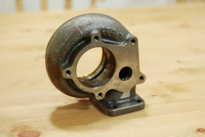

Mike posted a T25 that didnt have anything to do with this thread. You are correct about the ford housing. It can be used as an internal or external wastegate depending on how you run it and if it has the port for the wastegate.
Like with this
Other housings
gt housing
T31 housing\

The T3 and T25 are completely different. You have to weld the flapper on teh T25 shut if you want to run an external gate. As for the plumback, i dont think i have ever seen one fail other than someone not using a flex section when it needed one.

To run a T25 flanged setup (standard GT28RS, 2871R etc) with an external gate you have to weld the T25 wastegate flapper shut. You can't just block it off, because the swing valve/flapper is recessed into the housing, whereas with a 5 bolt ford style there is no valve, you simply block off the hole.
Now the GT28RS and some other turbos can also be used in optional T3 flanged housings, 4 bolt TA31 and 5 bolt ford, these housing can be run like any other T3 flanged turbo and an external gate, or internal gate with a flapper assembly that is commonly found on the "super 60" or "T3 60trim".
What's funny, is that of the 100's of Kinetic Motorsport VR6, & 1.8T turbo kits that have been sold with wastegate recirculation into the downpipe, which is all of them, I have never seen or heard of one failing, maybe it has something to do with the cast manifolds, or maybe 100s of people were just lucky.
T25 flanged housing
T3 5 bolt ford housing
