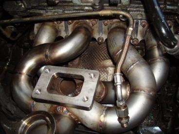

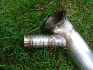

Originally Posted by nmocci
So do i need a dump tube? I guess im not understanding what your talking about. Do you have a picture of this? also the .48 is a 5 bolt ford hookup. This doesnt matter though, cause ill have the v-band.
i doubt the manifold is going to have a 5bolt flange on it...
heres the dumptube on the downpipe with a v-band flange for the tial 44mm wg
and my header with the wastegate tube and flange
he was talking about the discharge side of the exhaust housing when he said 5 bolt which means its a internal wg housing.
