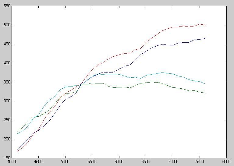

Depends. If you want a fast spooling turbo and worry free driving, i would go with a nice cast manifold. If you dont mind a tiny bit more lag and much more top end, atube manifold will make a huge differnce. Plus if you go with that, you really should go with a .63 housing so you can optimize flow.
Here is a good chart to show the differnce between log and tube.
GT30R
Compressor 76.2mm, 56 Trim .60 ar
Turbine 60mm, 84 Trim, .82 a/r
AER Stadalone Management (England)
Both Pulls @ 23.5 psi
Superflow Engine Dyno
Full Race
hp - red
tq - teal
ATP
hp - blue
tq - green
