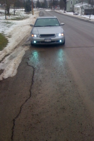

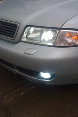

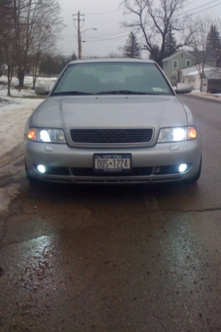

Today I installed a set of 6000k HIDs in my foglights. I know some people go with a 3000k kit for the amber beam, but I wanted to match the look of my headlights and maximize light output. I found that I had to upgrade the power wire leading to the fogs - my car is a pre-facelift and I used 16 gauge wire when I first installed the fogs, since they were halogens. Being that an HID system draws less current, it shouldn't have been an issue but nonetheless I had to upgrade the power wire to a 14 gauge. Once that was done, it was a cakewalk and they worked great.
A few pics:
Light output is great. The roads are wet here so I can't get a maximum light output picture, but once they dry up I will go out and take a few with only headlights and with headlights plus fogs. Overall though, absolutely worth the money. Looks pimp and seems to work very well

dude those came out awesome.. in the planning for my new headlight setup (which happens to be identical to yours, two piece depo/helix with 6000k and facelift fogs) i considered doing 6000k.. or halogens with yellow lamin-x.. or leave them regular halogen.. or possibly the ziza platinum whites from ECS.. but after seeing these i think i just might go the extra and do HID.. really looks sharp

lights look really good the color fits ur car as well. nice job
