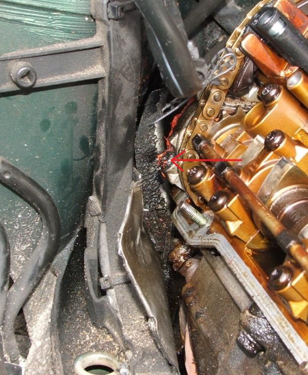

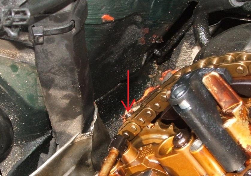

So I'm doing the Cam Chain Tensioner Seals on my son's 1998 A4 Quattro 2.8 and I'm having a heck of a time coming up with a T-30 driver which will fit between the lower Torx bolt on the right side #7 Cam Bearing cap and the body of the car. Are there right angle Torx drivers (ala allen/hex keys) available on the market or do I have to jack or tilt the engine to make enough clearance?

Any chance you could provide a photo? If i have a look i could probably recommend something for you.
I don't remember the body getting in the way of that job off hand.

Thank you for your willingness to have a look-see.
It's kind of hard to get in there well enough to give perspective; I can E-Mail you the full sized shots if that would help. You can PM me at shipo [put the "at" sign here] yahoo.com.
