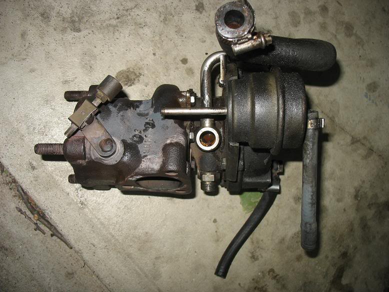

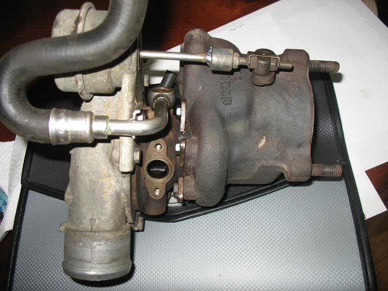

For whatever reason, I've seen a bunch of 97's turbo wastegate arms snap. That was my problem too. 0 boost but the car drives ok (but like a dog.) If you have no faults then thats probably it. I just took the turbo out and had the arm welded back together. I'd almost put money on it.
Broken wastegate arm:
Fixed:
It might not be your problem, but I'll tell you why it happens anyways..

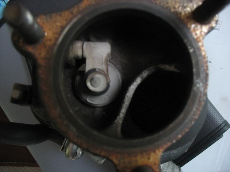

The wastegate flapper on the inside can become lose and bind when shutting, causing major stress on the arm and eventually snapping it. You would notice a boost leak or other symptoms when the flapper binds, but since you just got the car you wouldn't know. I used a C clip to tighten up the flapper so it shuts properly. Like this:
