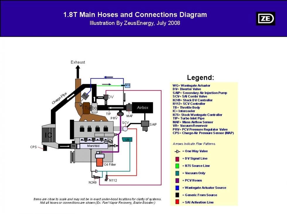

I just quit boosting on my way home from work... I'm guessing it's the crappy hoses... So all boost gurus can you tell me off this diagram which hoses to replace?

How the hell would we know that? All the hoses you need to look at are around where the intake line is. If you are going to be taking that out, check the hoses going to the N75 valve, and the wastegate. If you find one ripped or torn.............

*facepalm Let me rephrase this. I want to replace ALL small air hoses that effect the turbo, which ones need to be replaced? Which ones can be left alone?

Facepalm to my face! The ones going to the parts like i just told you NOOB! If you had a leak in any other line you would get a lean fault code from an engine vacuum leak. If you don't know which lines are for the EVAP system.. then you definately need a bentley manual.
