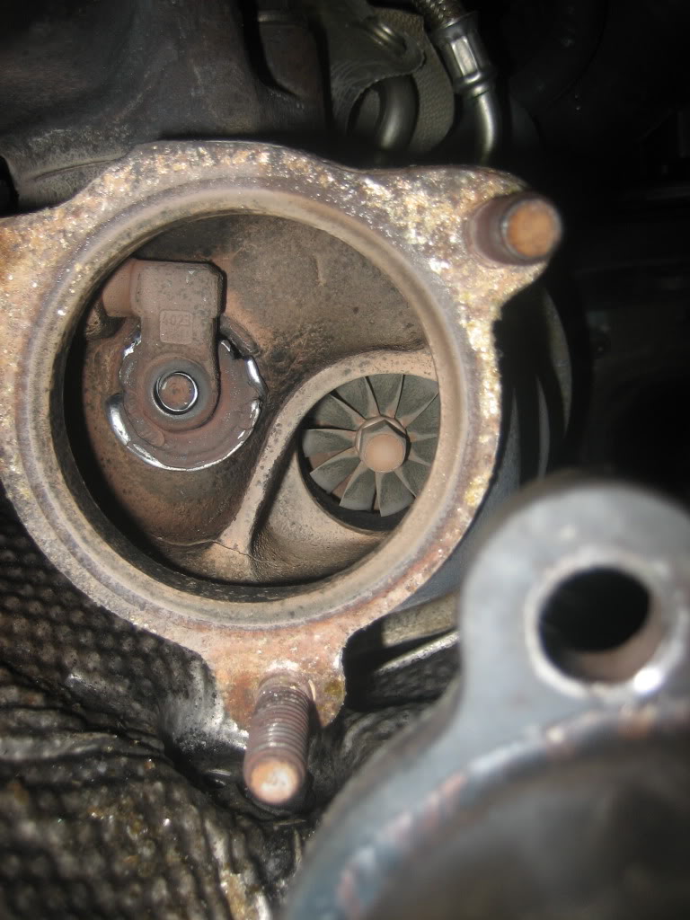

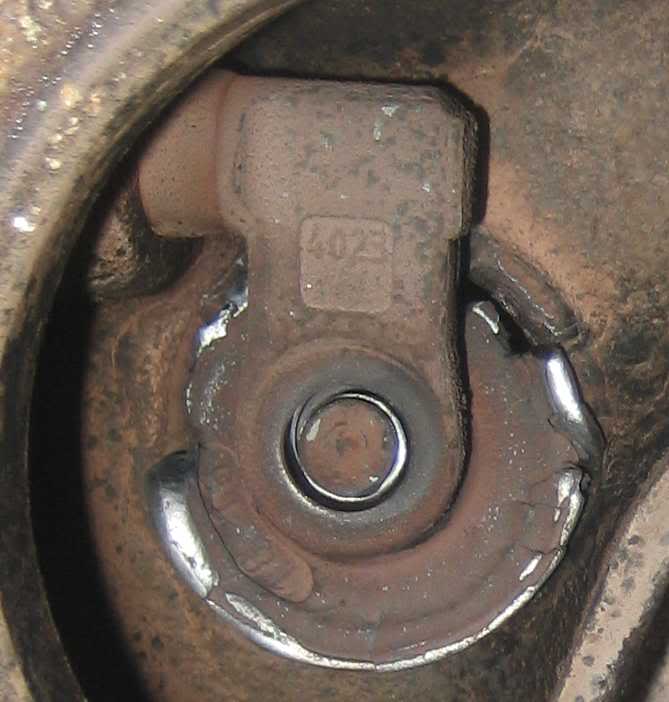

Today, I took the test pipe out (what a pain). I can reach into the turbo. The waste gate flap is all floppy, wobbling.
I took these pictures:
What should I test/try/feel/check on the wastegate?

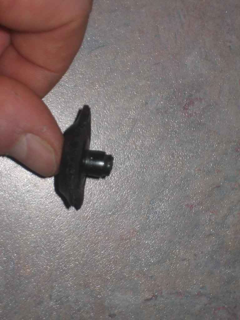

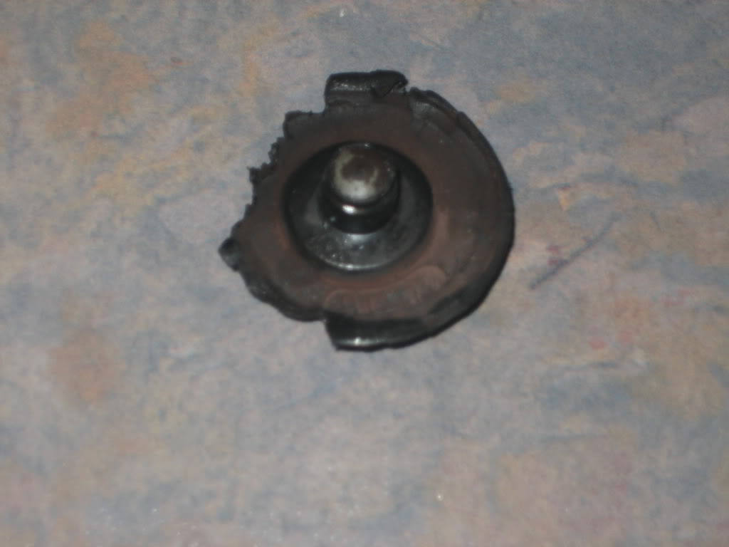

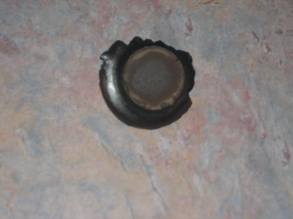

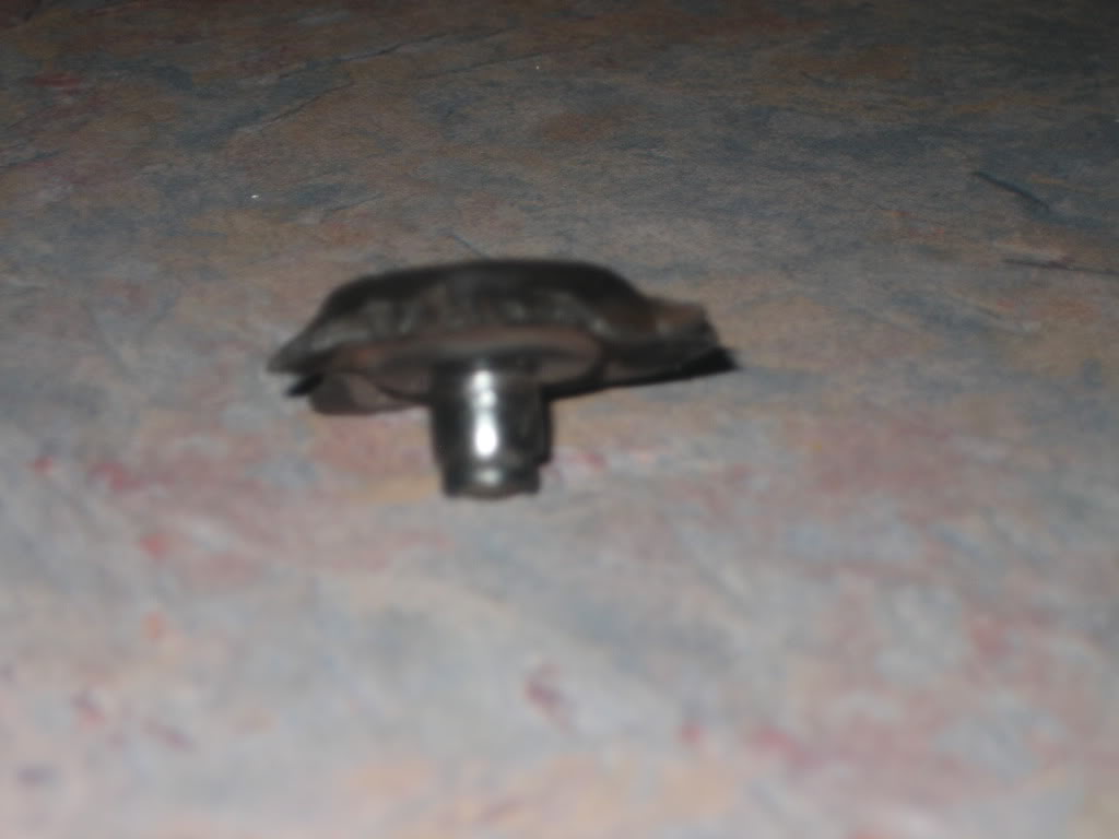

I got the turbo out (not sure if I will later get it in this way). Took oil return line off at the oil pan, took the bracket at the block off (impossible to get the screw on the turbo off)/
Twisting and turning got it out somehow (between the air box and the headlight).
The flapper was not anymore pushed closed by the spring of the actuator. Adjusting the set screws on the actuator probably would have been all there is to fix the problem.
Now, after months of driving around with reduced power and a rattling wastegate flapper has ruined the flapper. Not sure if it can be replaced.
See pictures below.
