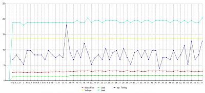

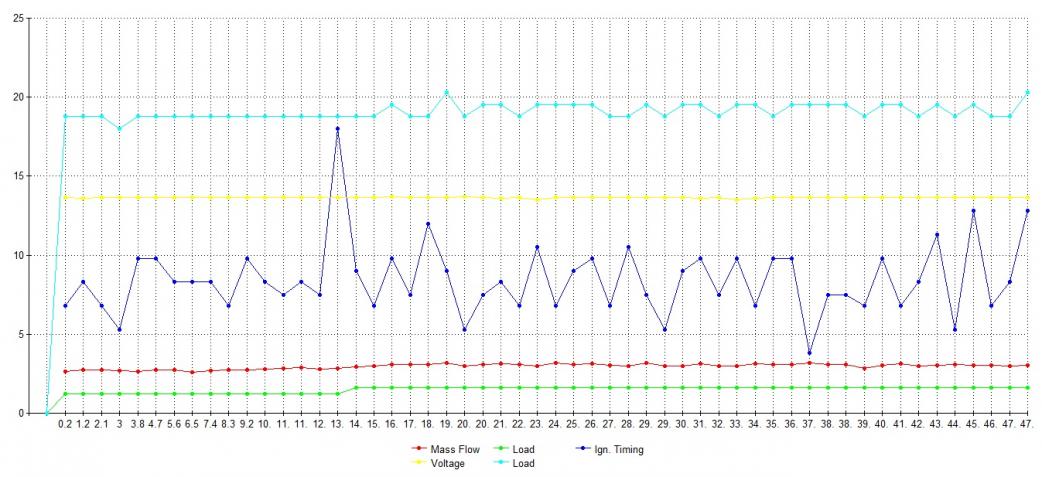

Posts: 85
please confirm suspicions of the CCT, log of my BTDC graphed picture below, it spikes and drops, i do have a flash of unitronic stage 1, ngk brk7e i think plugs, gapped to flashed size, forget what it is .028mm i think, less the a year old coilpacks from audi, compression was a 180-200psi threw out all four, only run 91oct, and do fuel system cleaner once or twice a month, and crankcase 5 min flush after every 5000 kms
horizontal numbers are timestamps, and vertical numbers are whats goin on lol
