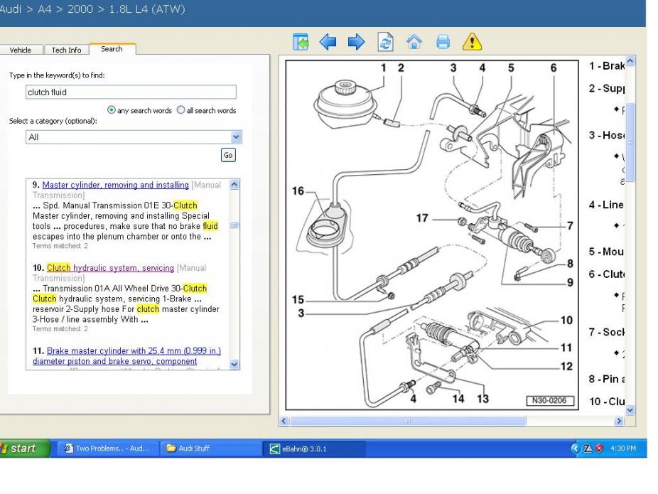

by the looks of it, its the brake resovior. maybe someone else will chime in

Every car I've owned used brake fluid for the clutch system. The brake res. is roundish all the way towards the back of the engine bay, drivers side. Its semi concealed under the plastic panel.

Yeah it T's into where the brake fluid goes, you can see a rubber hose coming out the bottom heading to the drivers side.
