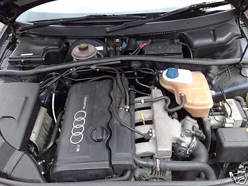

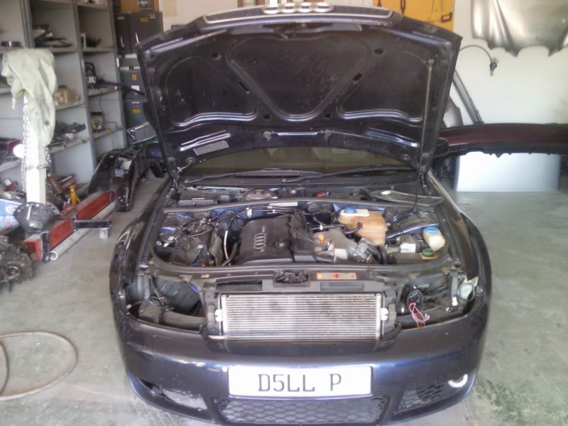

The base car, B5 A4 1,8T Sport:

Side note: These are old pictures, before the current owner got his mitts on her. She looks very different now - no RS4 badges, now sporting 1-piece ecodes, and M3-style trunk lip.

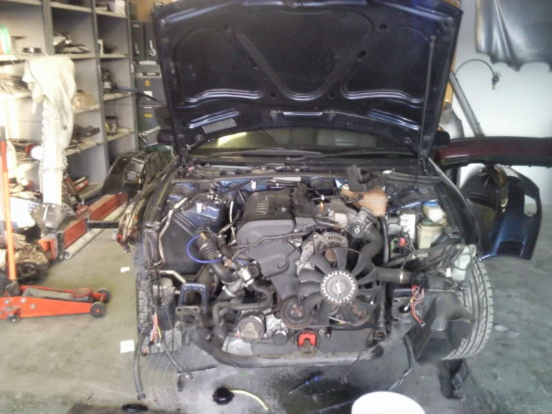

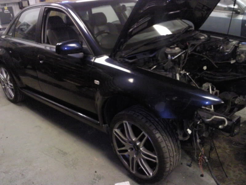

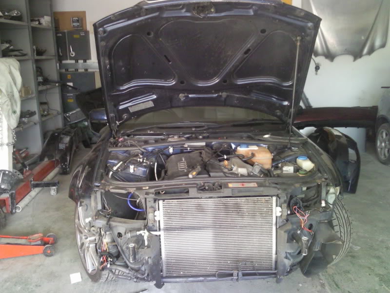

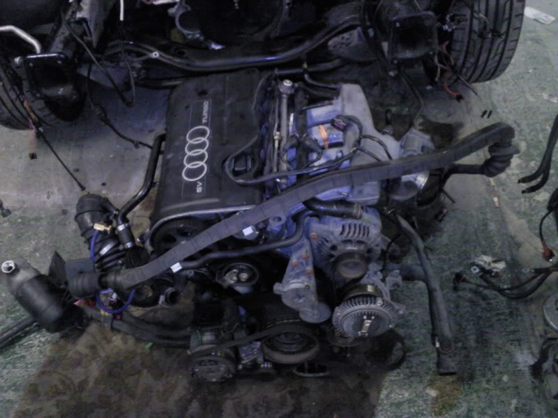

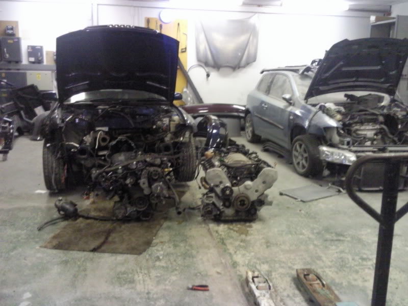

The teardown began today...
Outgoing 1,8T engine:

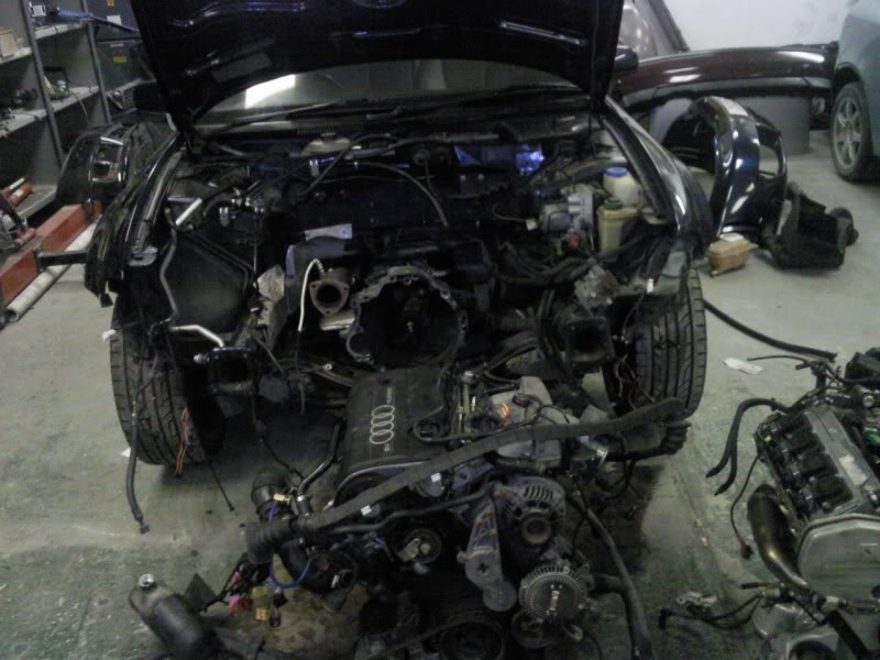

And so the teardown continued:

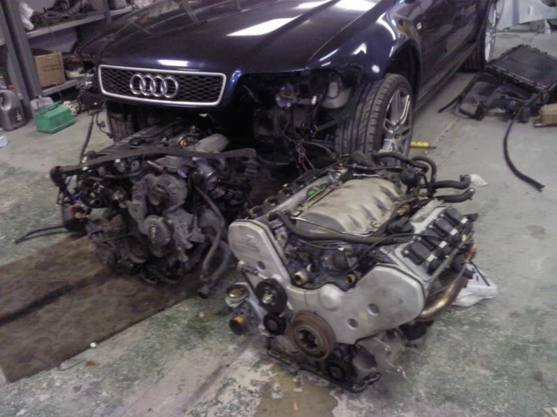

Little boy 1,8T:

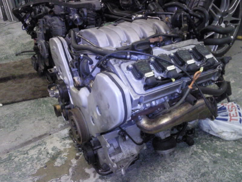

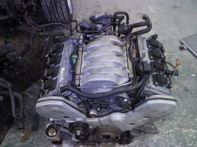

Big bad boy S8 32V!
Fancy kicking that big lump into the B5 bay?

that's the s8 engine that looks like my 04 a8 engine 4.2l?
Old Sep 22, 2009 | 06:30 PM
Siena's Avatar
Joined: Mar 2008
Posts: 235
From: Suffolk Coastal, UK.
Similar, though S8 motor has a higher redline - 7,000rpm, and solid tappets on the exhaust camshafts to cope.
Throttle body and intake plenum are larger than A8 / A6 4,2L, and CR is higher - 11,5:1.
