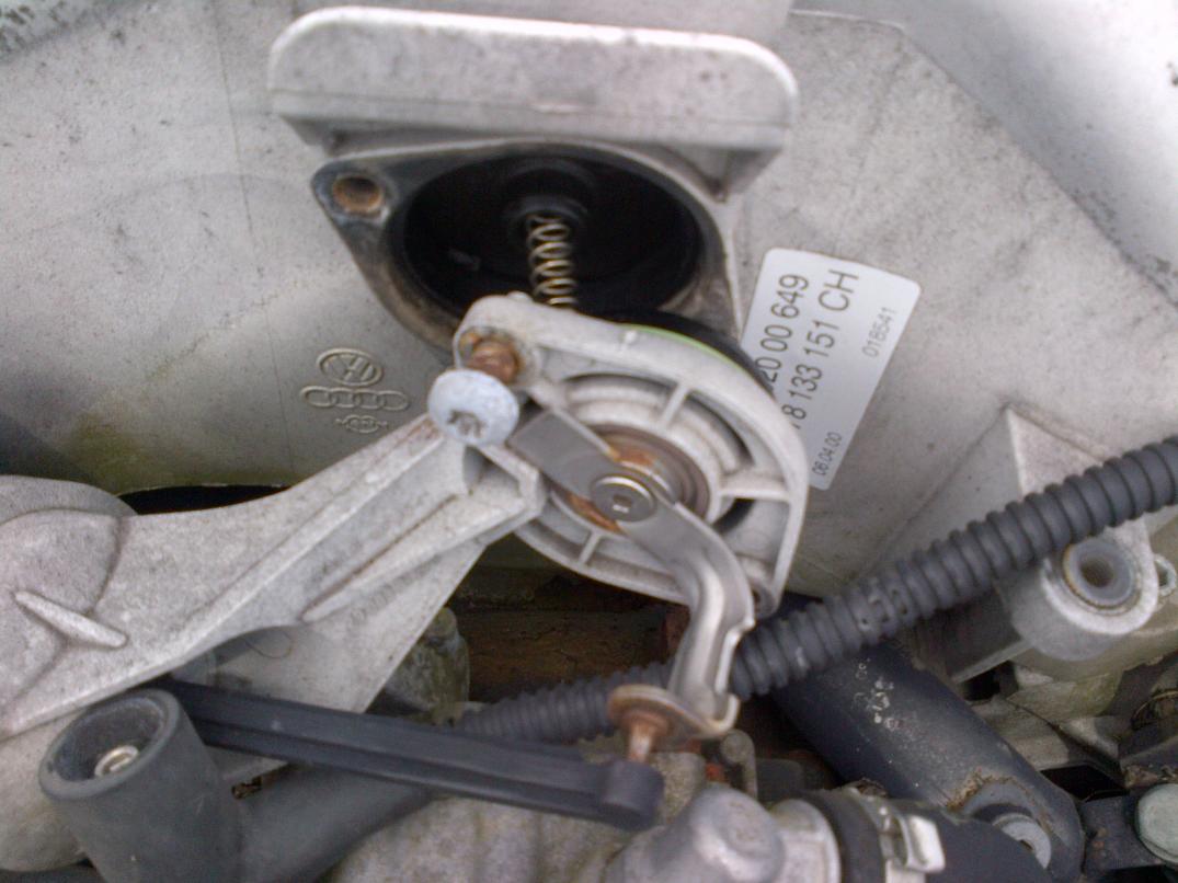

Old May 9, 2014 | 04:00 PM
Iguana6699's Avatar
Joined: Aug 2012
Posts: 13
Default Location of Spring
I took one apart at the scrap yard first to make sure I knew where spring was. Took photo.
Attached Thumbnails Vacuum hose coming out of vacuum reservoir replaceable?-spring-location.jpg
