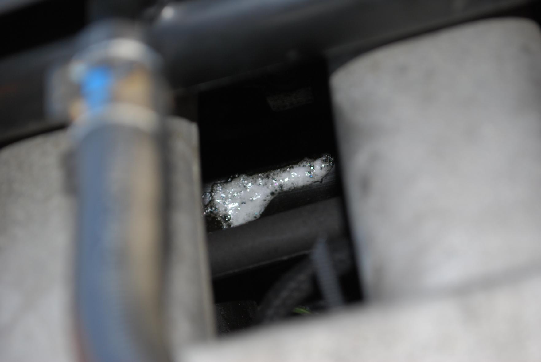

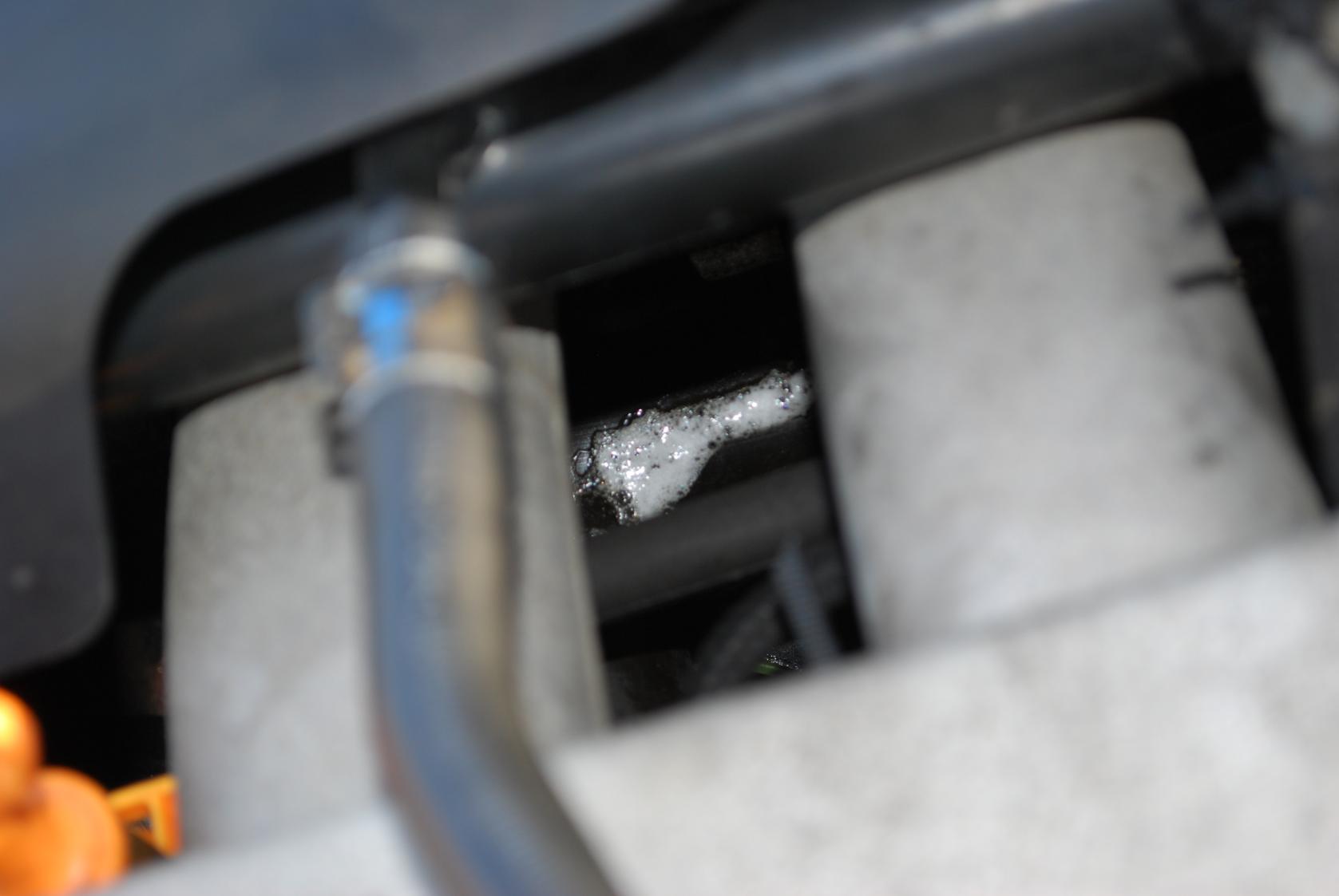

00 Giac x+
keep getting the p1136 too lean code, did a boost leak test and i found a small vacuum hose in the back of the engine that was hanging by a thread, i think it goes to something called the combination valve for secondary air injection. Replaced that but i found a bigger hole. I am not sure what the actual part is, so my question is does anybody know what it is what it does. I put some gorilla glue one the hole hoping it would help until i get a new one but no luck. the part is located on the right side of the engine, underneath the intake manifold.
hope the picture helps
thank you.
