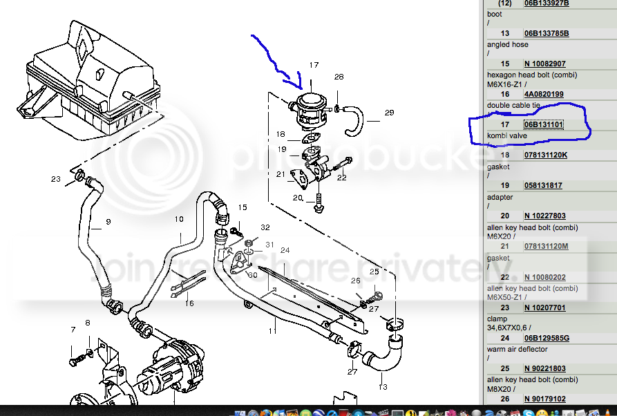

Ok i just came from the Repair shop, the guy told me its the "Diverter Valve"
but wut i want to order(is not in stock, so i have to wait idk how long) looks a little bit diff
but also, notice thet the guy was not 100% sure of what he told me, so wht can i do?
could this make that weird noice? should i stop driving mi car?

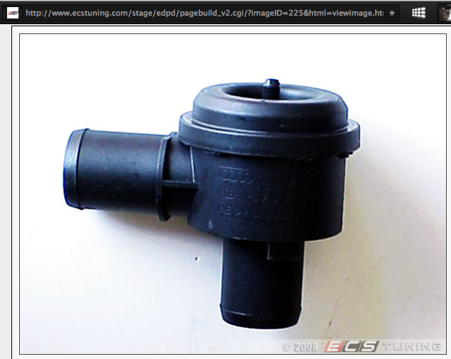

also what they have in stock at ecstuning is this..
but it looks like plastic, and whats in the car looks kind of like the first picture..

If you are running stock just get the plastic one... If you are chipped or runnin k04 or better get the forge. Up to you though both work and not that expensive either way. Also, you don't need to wait for an online order if you get the stock dv locally
That's not the diverter valve. That's the combination valve (#18 in the pic), which is primarily for cold engine starts.
The diverter valve shouldn't make a chattering noise and if it was it would be located near the passenger headlight.
