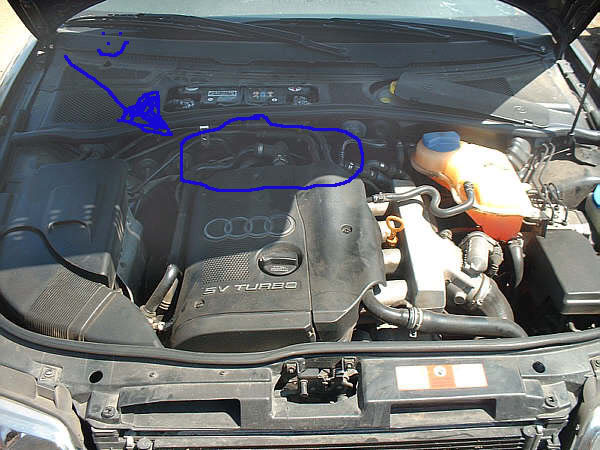

Originally Posted by pimphell
I agree with him on the cam chain tensioner ^ Thats most likely what your hearing
is not the tensioner, cuz the noise comes from this part of the engine

That's exactly where the cam chain is located. The combination valve is also back there.
