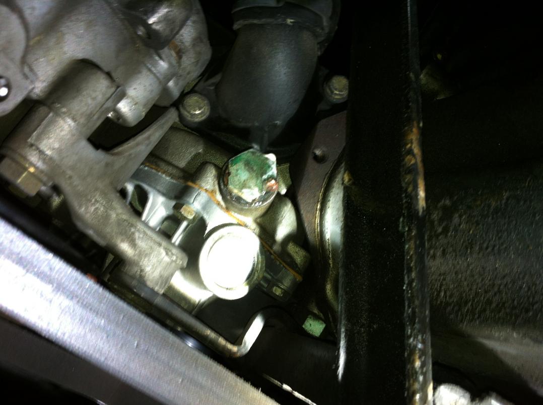

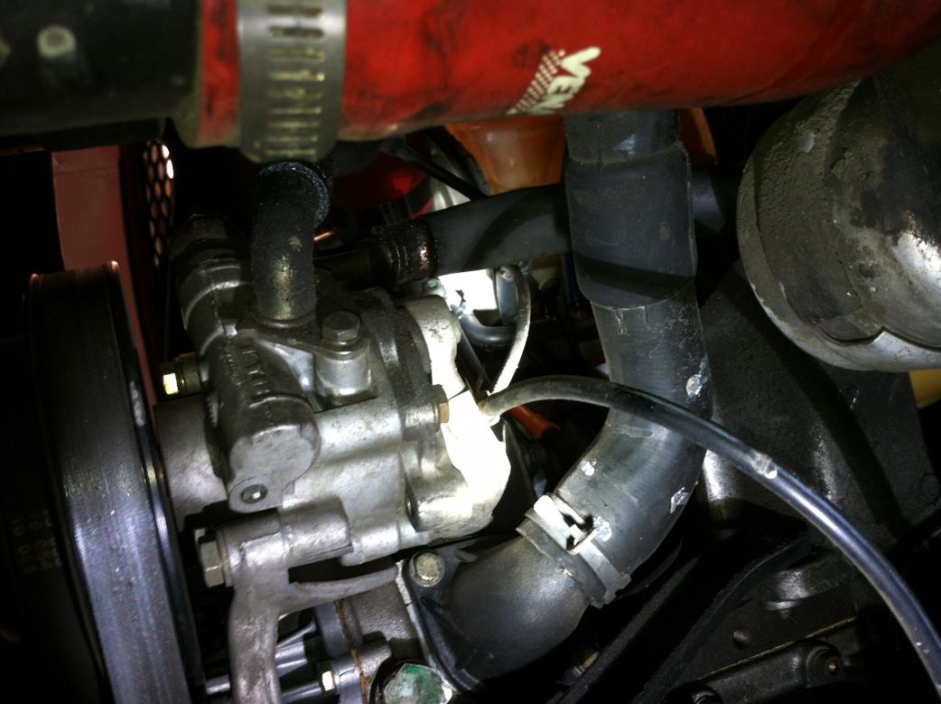

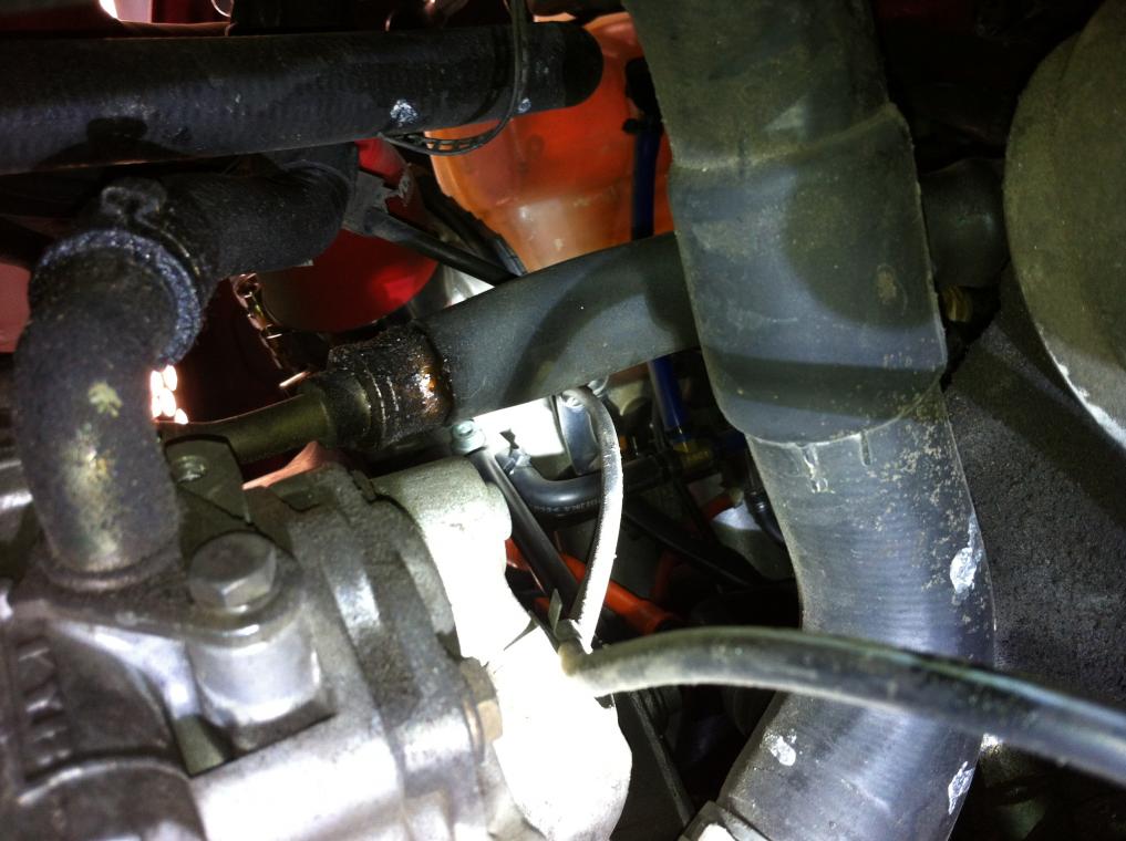

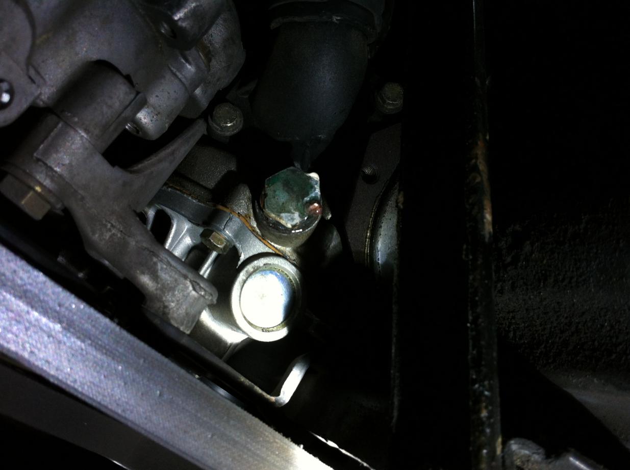

What's up everyone, haven't posted here in a while... Just did an oil change and found this small leak from what looks like a drain plug on the water pump housing. Is this normal, should I just tighten the plug/bolt and maybe add some teflon tape or is it a sign of the pump needing to be replaced? Also, is this power-steering line difficult to change?
thanks

I personally would replace the water pump...here's a write up on doing the power steering pressure hose...
Power Steering Pressure Hose 1.8T Replacement.

In many cases, a water pump comes with a weep hole to indicate a seal has failed. I do not know much about the external 058 water pumps, but I'd imagine they have a weep hole. If it is indeed coming out of that hole, you need to replace the pump

Ok cool, thanks everyone. i did a timing belt change about 15k miles ago but ill prob just do it again.
