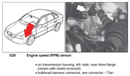

Unless the 12valve v6 is much different from the 30valve, it doesn't sound like you've replaced the correct sensor. The symptoms you describe and subsiquent code are consistent with CPS failure, but the sensor location does not. The CPS on the 30v and 40v engines is actually mounted to the transmission bellhousing. Take a look at the driver's side of the trans, just behind the block.

That's why I asked what sensor you are replacing, the CPS sensor should be on the tranny bell housing on the 30v....so I believe you are replacing the wrong sensor.....that's why the code keeps coming back.

It's in the same area as the 30V from what I know. Attached picture.
The speed sensor should be mounted on edge of the bell housing of the transmission above the teeth of the flywheel....
