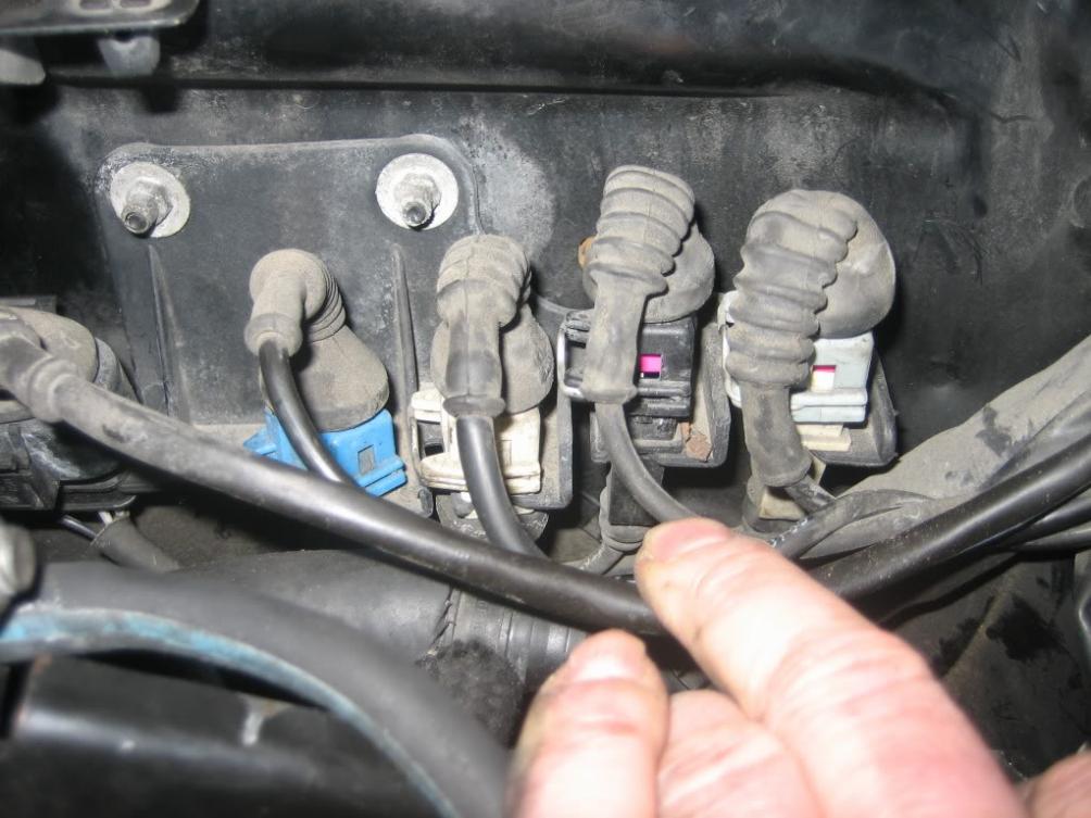

I am in the middle of a engine swap on a 12 valve afc engine on my 96 a4 2.8. We have the new engine in and we are getting ready to put the intake on. I have one plug i cant seem to figure out where it goes. In the picture it is the white plug beside the blue on on the left of the finger pointing. This set of plugs is on the drivers side of the firewall.

I have the top section you can see in the picture but i cant seem to locate the bottom piece that it connects to. Does anyone know what this connects to or where it runs once it leaves the firewall. This engine swap has been some what of a nightmare lol

Thanks it's the last plug and I can't seem to find out where it goes. On my parts car it is cut.

The top half should come from the ECU and the bottom section snakes under the intake manifold and goes to the ignition coil pack. The other harness from the coil pack goes to the icm on the airbox.
