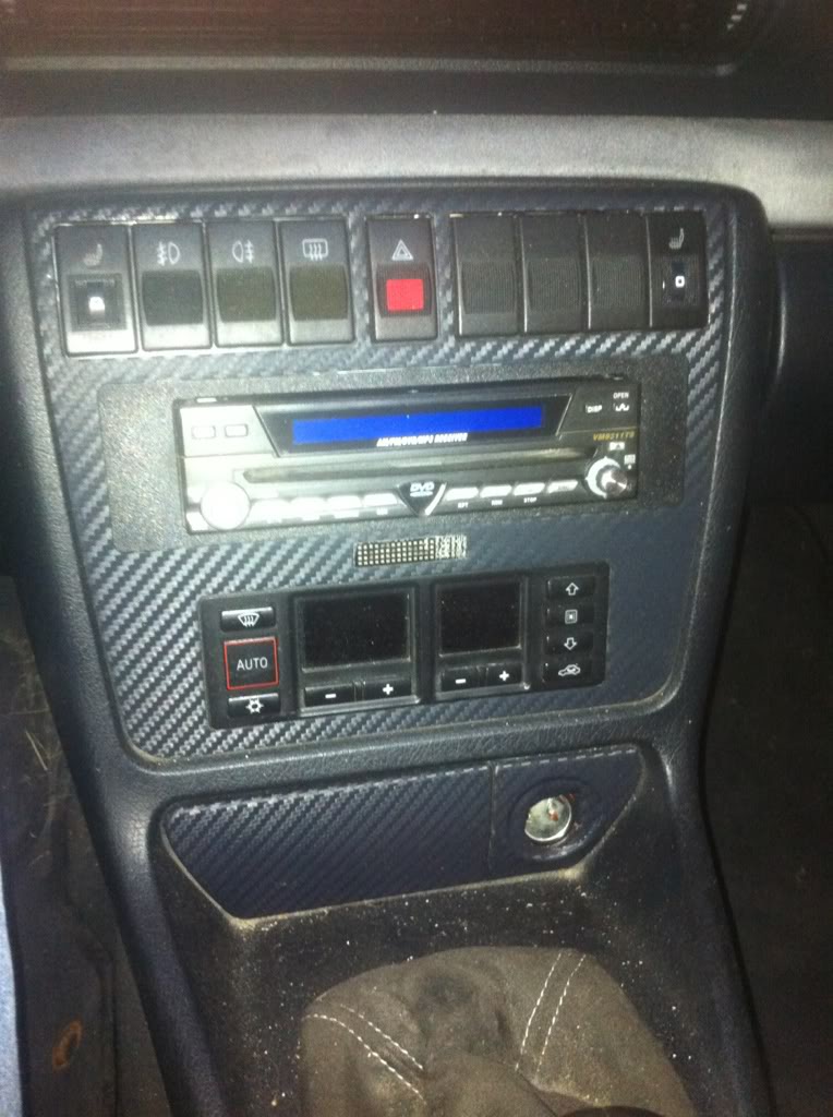

Went from this:
To this:
I did the double-din facelift console and also installed a short shifter as well while I was in there. I love the shift throw length but it's crazy stiff so I need to figure out what to adjust to make it a smoother action (suggestions?) or it's gonna drive me nuts. Spent about four hours in all. Not too bad except it was hot as ***** and I'm soaked in sweat. I was looking at speaker bracket adapters but I might actually just source a set of OEM speakers and put them in and call it a day. I also need to try grinding the shift plate down a little inside the opening since my pre-facelift shift boot assembly won't snap in as it is. I just threw the alcantara boot over the opening temporarily until I get around to modifying the plate. For today though, I'm done.

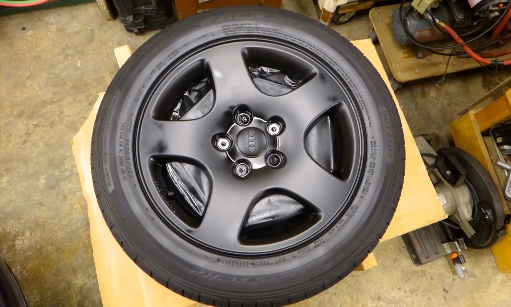

Just picked up 4 cans of matte black plasti dip.

That looks much better, Did you have to do any mods to the wiring for the climate control or switches?

Planedr, yes there's a little bit of wiring but nothing remotely difficult. Extend two defroster wires, add a wire to one pin on the HVAC panel connector to provide illumination, tap into an illumination source and a ground to light the cupholder and ashtray (which I didn't bother with), and you have to extend the 12v outlet wires since it moves from the vertical console back to an area near the e-brake. Very, very easy to do. I love the results - ill finish it off soon once I get to the junkyard - I need the foglight module from behind the glovebox to make those lights operational (that IS a lot of wiring), and I'll light the cupholder, fog/ESP buttons, and ashtray then.
Lukas, I gotta say I wasn't sure about the plasti-dip idea but that looks cool!
