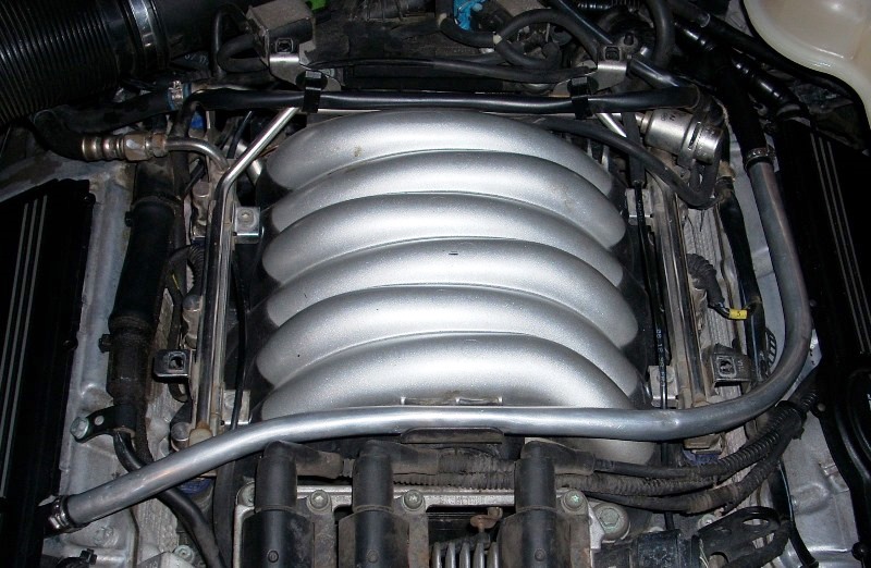

I replaced my brittle plastic crankcase breather hoses with aluminum pipe like I saw on bshusted's V6. Turned out OK, I'm not a great pipe bender.

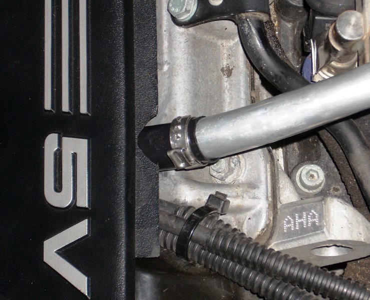

Had to shave a little on the shroud to get it over the pipe here.
