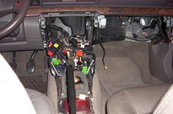

Taking the day off tomorrow, started my heater core job tonight. Got a pretty good start. Pass airbag is out, most everything in the middle. Can still drive it, have a 9:00 AM tomorrow to suck out the R134a, then I go at it hard all day.
Well this looks like a ton of fun...

We'll be doing the heater core in my friend's Passat this fall. I'm not looking forward to that. It looks even worse once the whole friggin dash is out.
You mean like mine looked at about 2:30 yesterday?
Ya know Devil this is the 3rd time I've done this on a B5. I always used Kris Hansen's DIY from over at AudiWorld. He took the entire aluminum frame out, including disconnecting it from the wiring harness. I've never done that. I've found that if you slide the ductwork off the bottom of the HVAC box, you can snake the box out with the aluminum frame intact. I did, however, take off the bolts at the end of the frame, the bolt for the pedal assembly and the one that ties the frame to the car in front of the steering wheel. That way I can move the frame out just enough to help me out.

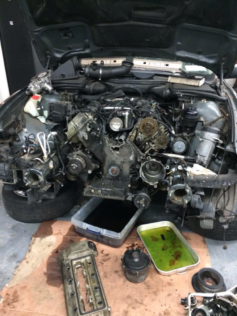

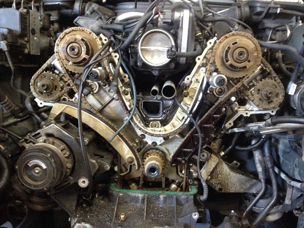

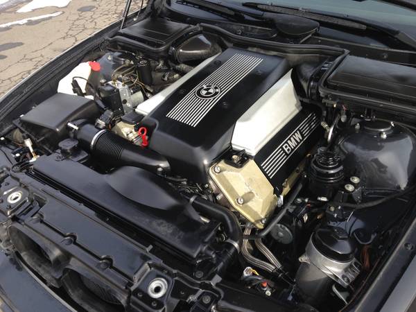

For sure. But I'm definitely gonna take my time on that one. Gonna turn it into probably a week-long project and do the VANOS seals and valley pan gasket at the same time, paint and powder coat some stuff, and in general do any cleaning I can do while I'm in there. From this:

Gotta get the A4 back together soon and get it fixed and inspected for winter before I start thinking about this job though.
