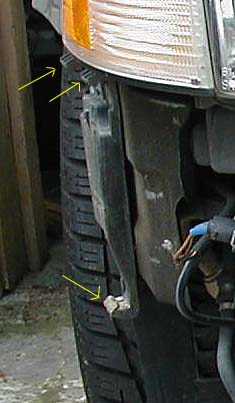

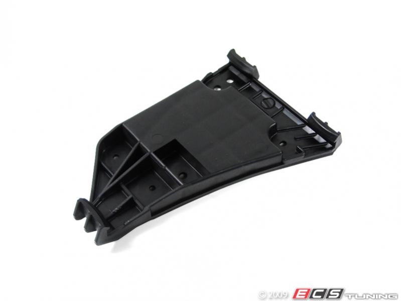

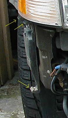

But I'm having trouble with fitment of front bumper and front fender on sides. Can't find any photos of bumper/fender gap, any of you guys know if it should fit 100% or if bumper should be off by 1/4 inch?

It should fit 95-100%. It is likely not all the way locked back in to the plastic claw that holds it on each side. It is tricky the fist time you do it. Feed the bottom tab downward into the claw on the body, once you're sure it is in there correctly, you have to push down and in at the same time to get the top part of the claw to lock in with the clip on the bumper. Hopefully these pics help.
