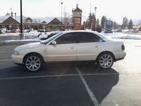

So i bought a set of H&R Sport lowering springs, i thought i coul just swap them over with the Oem ones on my car and be able to lower it without any issues. But now I went out asking who will install them they told i shouldnt lower my car, That my Camber is gonna go bad and nobody was able to help me find a way to fix that... So what do i do?
Is just changing over my stock springs for the HR springs not a good idea?
Attached Thumbnails What do i NEED to Correctly Lower my car!?-0217111544.jpg
