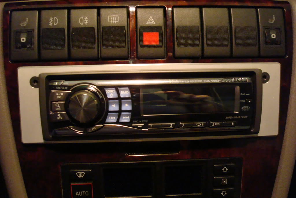

I made my own out of aluminum. I've been too lazy to paint it black.
Old Apr 16, 2008 | 10:34 PM
nrowensby's Avatar
Joined: Apr 2008
Posts: 100
Default RE: What radio facia kit are you using?
What did you screw the aluminum facia piece to? I have been debating on making my own, but I don't really see anything to mount it to...
Old Apr 16, 2008 | 10:54 PM
manufan's Avatar
Joined: Jun 2007
Posts: 278
I have a slight advantage in all this, I'm a machinist. I made stand-offs.I took a piece of aluminum about 3/8" in diameter, drilled and tapped it through with the same thread as the bolt that holds the wood-grain piece in. Loctited a stud in one end and then tightened it in place of the bolt that normally holds the wood-grain piece in. I mounted the stereo sleeve to the aluminum plate, slid it in place and screwed it down with the flat head allens to the threaded side of the stand-offs.
