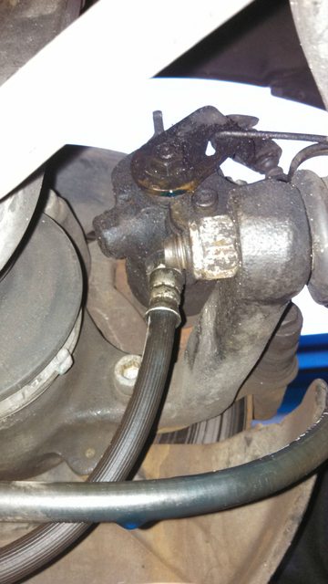

I noticed my bake fluid was leaking so I refilled it, parked on a dry surface and waited overnight to find a puddle. Lo and behold it was the passenger side, rear wheel.
I took the wheel off, and stared at a bunch of stuff I have no idea what it is.
The leak is coming from the inside of the caliper (I'm fairly sure), but after that I have NO clue.
I managed to snap some crappy pictures with my phone so I hope that helps you guys give me an idea of what to do next:
This is looking up and out from behind everything (the wheel being off of course). You can see the bolt at the top where the general leak is coming from and it falling onto the hose below.

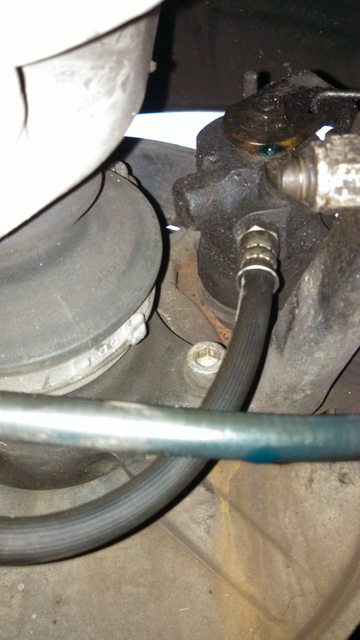

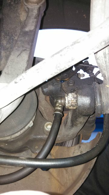

here's two more that are essentially the same thing:

(i'm 100% certain its not a small hole or anything in that lower hose, I cleaned that and watched the fluid drip onto it, not from it)
So my question is simple, what do I do? Whats the next step?

you are probably looking at a piston seal or such. you can rebuild it but I am not sure where to get the parts from

Piston and seal kit wouldn't solve that one. That's leaking from the e-brake lever. Better just get a rebuilt caliper...about $75. No need to do them in pairs. It's the beautify of hydraulics. The new one isn't going to press any harder than the old one.
