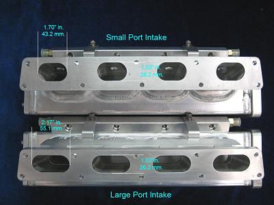

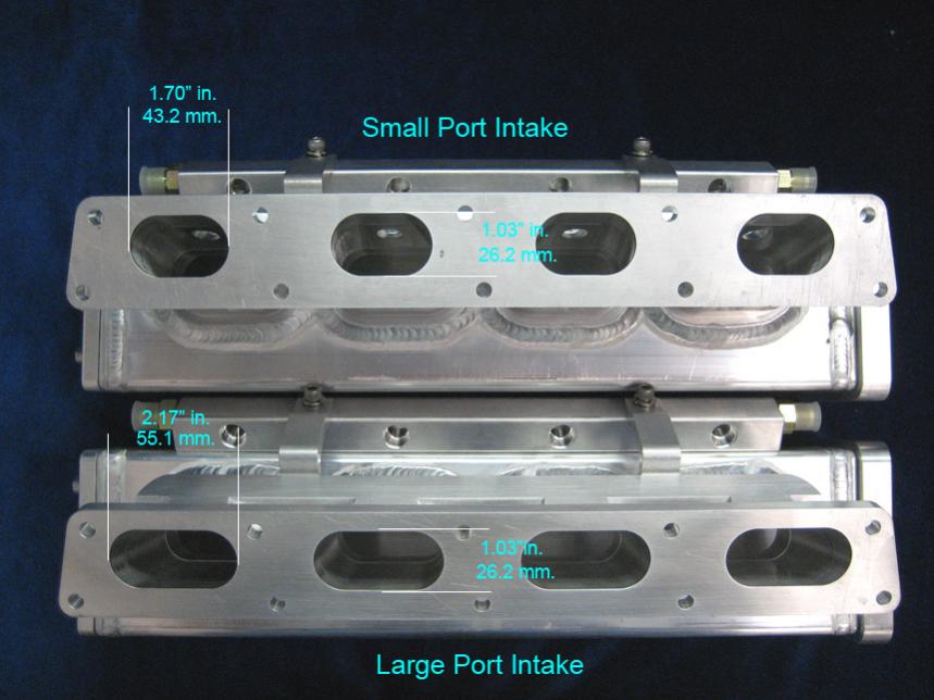

Originally Posted by ThatRetardedKid
I heard the AEB motors can be very very nasty in good terms I mean.
The AEB head has larger intake ports, allowing more air to move more efficiently.
Attached Thumbnails Whose 1.8t made at least 250 hp or near 300hp-20v1.8tintakeportsize.jpg

Oh man thats a good difference. Mm.... what about stock bottom end potential #'s
