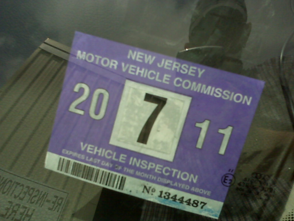

Well as you can see the window was repaired. What a pain in the *** though. The top two rivets on the regulator were a *****, covered with the green plastic brackets. I don't want to do that job again.

New Jersey? I could have sent you a sticker
