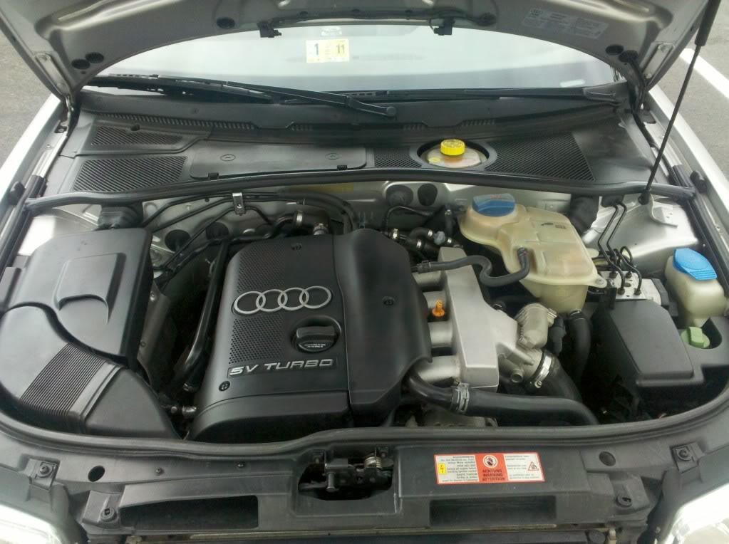

Here's a pic of my engine:
If you pull up the plastic cover on the left there, and disconnect the snorkel that funnels into the air box, you should be able to see the turbo inlet pipe. Thats where the filtered air heads for the cold side of the turbo. If you pop that off the front of the airbox, thats where your MAF is. To get to it, you gotta move a bunch of other **** out of the way and take the airbox lid off and flip it over, and you should see this:
