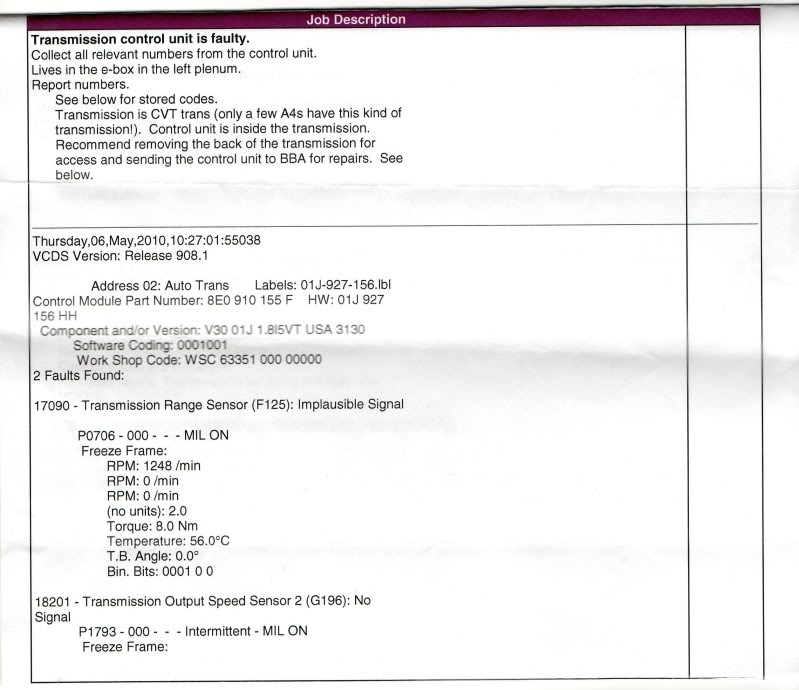

I had the flashing lights on my dash light up on my 2004 A4 1.8T. Which has the CVT transmission. The cost was $1,800 US and the mechanic had to take the TCM out of the transmision. The dealership will probably charge more of course. Replace it with a new one and also program it with the current codes. If I new this happened to the CVT models I would have not bought one. But since I got mine replaced the car has been fine since. (knock on wood) Changing this out by yourself can be done. But, programming the new TCM might be another obstacle. I can try and post up my invoice if, you want to see what was exactly replaced. Just let me know. Good luck with your fix.
