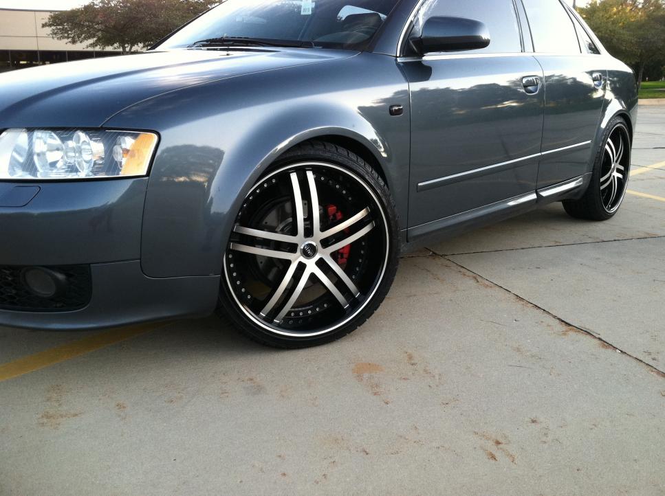

Hello gentlemen,
I am new to this place, but my 2004 audi a4 3.0 timing belt went out on me yesterday . Beside being mad at myself for not changing it when i was told, i have a question for you guys the pros. Is it possible instead of replacing the same stock engine, but to go with 4.2L v8? cuz my friend found one dirt cheap from an s4, cheaper than replacing with my stock. And if i go that route what should i be aware of or watch out for.
Thanks in advance for your help.
