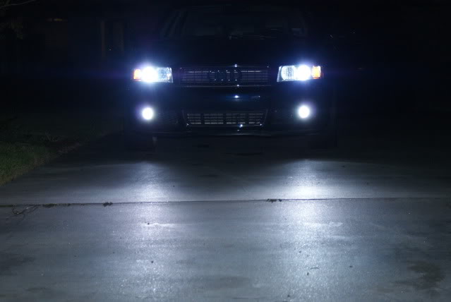

its common knowledge. Honestly why are you putting leds in your fog lights? WHy not just install hids and call it a day. about 100 times brighter and will match your headlights if they are hid. . . . plus you can obtain a hid kit for under 50 bucks. once you buy the resistor and the leds you will pratically be up to that price with very little light output.
pic for reference
